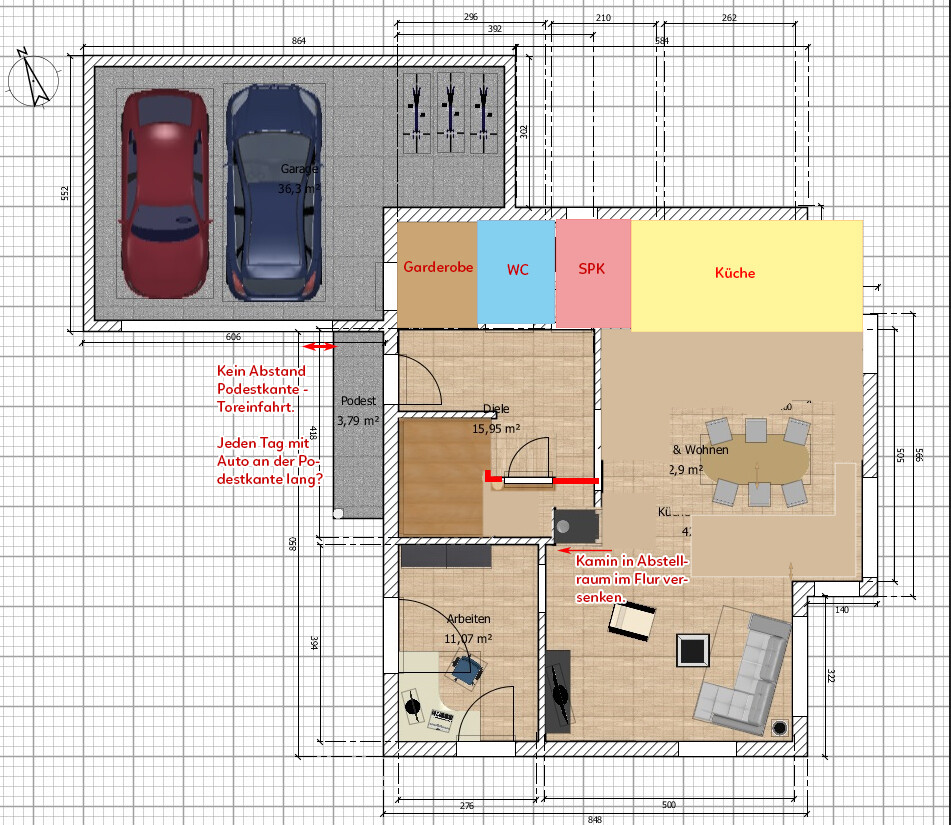

kaho67425 Jun 2018 10:56
I see several issues to address here:
- Dining area is too small
- No cloakroom at all
- Utility and technical room are much too small
- Pantry door disrupts the kitchen layout awkwardly
- Upper floor bathroom can only be accessed through the private dressing room – guests have to go downstairs?
- Sauna should ideally be next to the bathroom or even better integrated into it
- Access through the technical room is 2m (6.5 feet) away from the main entrance – that doesn’t make sense. Better: a covered entrance area
- Garage driveway is too close to the platform. When parking the second car, you frequently scrape the tire against the platform edge
If I were you, I would consider relocating the technical room upstairs. You have spare rooms up there, which you’re already worried might go unused. In return, I would add a cloakroom on the ground floor, move the toilet and pantry, and widen the kitchen (I would extend it to the full width of the bay window, depending on the kitchen layout). This would create plenty of room for a large, beautiful dining table as a central feature when the children visit.
I would move the fireplace into the hallway, and in doing so, create a storage closet, also including the space under the stairs. This way, only the glass fronts of the fireplace would be visible from the living room.
On the upper floor, I would create a separate entrance to the bathroom for guests. By relocating the door, you also gain more usable space in your dressing room. The sauna should be integrated into the bathroom (replan the bathroom layout!). When the guests are away, I would use the guest room as a studio.
This is a rough sketch made quickly, so there are certainly opportunities for further fine-tuning:

kaho67425 Jun 2018 12:12
Deliverer schrieb:
That looks good, Katja, but I think if he had wanted to leave out a guest room, the floor plan would have been different from the start...
Exactly.
If you need two guest rooms at the same time, I would consider separating off the study downstairs and adding a shower to the bathroom.

kaho67425 Jun 2018 13:14
kbt09 schrieb:
@kaho674 .. Katja, but currently one room is missing, right? For the future, I would also plan the sauna in the room next to the bathroom in the current layout. And have a wall opening prepared there as well.
As I said, there are two adults, and the children are guests, if I understand correctly. So I would plan a large guest room upstairs (for 2 children) and use the downstairs office optionally as a second guest room with a shower in the guest bathroom. The guest room upstairs I would use as a studio once the children have moved out, and the room downstairs again as an office. Much more important in the future will be the large dining table that can quickly seat 12 people, because when the children are older, they rarely stay overnight but like to come for meals.
