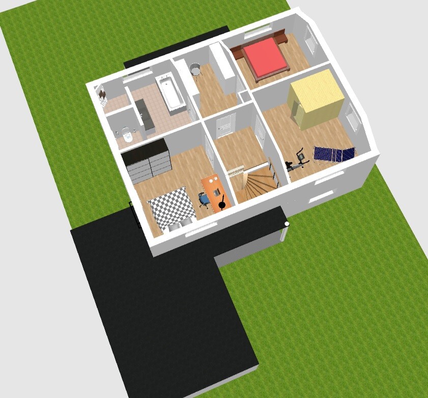

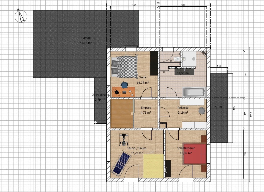

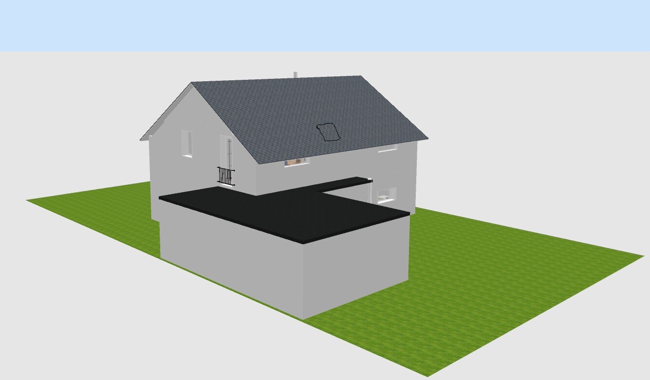

I have been following this great forum for a while and would now like to share my current planning status – since many eyes can surely see more than just four.
We have been planning to build a house on a plot at the edge of a field (unfortunately facing rather east) – ideal for 2 people, but definitely suitable for 5 since my children from a previous marriage still visit regularly. Therefore, some rooms are planned as children’s rooms initially but should be usable later for other purposes (sauna, guest room, etc.).
At the moment, the land situation is still tricky and may take a few more weeks – so everything regarding the design is still open, meaning it is all still in the "pre-planning" stage...
We ourselves are two working adults who enjoy cooking, walking, and wellness – and need little “waste space.” However, there is an “inner conflict,” as one prefers open, spacious rooms while the other prefers a cozy atmosphere. After several attempts with an age-appropriate bungalow with a basement, and an urban villa with a hipped roof, we have currently settled on a “classic” detached house with a gable roof, but with a high knee wall (1.70m (5 ft 7 in)) as a compromise between coziness = sloped ceilings and open space = full ceiling height *g*.
More about us gladly in the discussion. I have now started with the questionnaire:

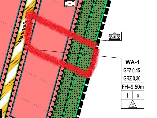

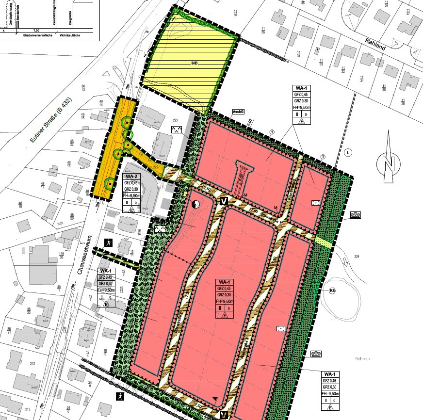

Plot size: approx. 700 sqm (7,535 sq ft)
Slope: No
Site coverage ratio: 0.30
Floor area ratio: 0.45
Building plot, building line, and boundary: Building plot on the street side, field edge location, area towards the field to remain open for nature conservation/hedgerow. Building area approx. 500 sqm (5,382 sq ft) of the 700 sqm (7,535 sq ft) plot.
Edge construction: No special conditions
Number of parking spaces: 2 required
Number of floors: 2 full stories permitted
Roof shape: All types permitted
Style: Everything except log cabin houses permitted
Orientation: East-southeast
Maximum height/restrictions: Max height 9.5 m (31 ft 2 in)
Other requirements: Minimum 3 m (10 ft) distance from street to garage/building
Owners’ Requirements
Style, roof shape, building type: Modern, clear, open: gable or hipped roof (possibly 2 shed roofs?), urban villa or classic detached house architecture
Basement, floors: Rather no basement, instead 2 floors + usable attic
Number of people, ages: 2 (around 40 years old) (+ 3 occasional visitors/kids aged 9, 12, 14)
Space Requirements on Ground and Upper Floors

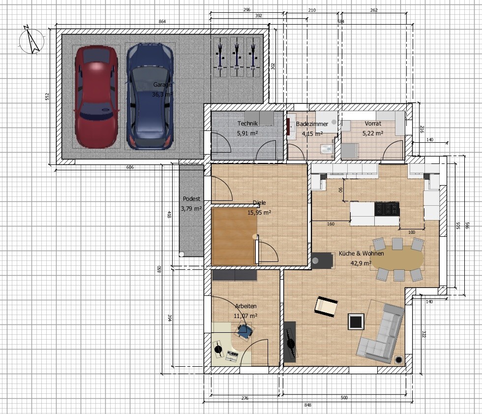

Ground floor: Open living, dining, and kitchen area (generous kitchen + pantry?), office, utility/technical room, guest WC
Upper floor: Children's room 1 (later guest room), children’s room 2 (later sauna/gym), master bedroom, walk-in closet, bathroom
Office: Home office
Guests per year: 3 children (9, 12, 14), occasional guests
Open or closed architecture: Preferably airy and open
Conservative or modern construction: Rather modern
Open kitchen, kitchen island: Both options welcome
Number of dining seats: At least 6
Fireplace: Yes, preferably visible from living, dining, and kitchen areas
Music/sound system wall: No
Balcony, roof terrace: Not necessary, possibly a roof terrace on the garage?
Garage, carport: For 2 cars, possibly workbench, tools, bicycles
Additional wishes/special features/daily routine and reasons:
- Different work schedules require that one person can get up early, get dressed, and get ready while the other can continue sleeping
- The 3 children will eventually visit less regularly or no longer all at the same time -> rooms need to be usable long term and flexibly
Designed by: Basic design by a prefab house company, further modified by myself in SweetHome3D.
What do you like particularly? Why?
- Connecting garage to the main house (dry access with groceries)
- “Parents’ wing” (one door closed, no one getting into our closets or bedroom)
- Room usage concept (no rooms that become unnecessary later)
- Pantry behind kitchen (can house grain mill, non-decorative appliances, etc., in the back room)
- Office next to living room: During tax time, you’re not separated from your cooking partner and remain within calling distance without a walkie-talkie
What do you dislike? Why?
Pantry has no connection to the garage – open kitchen might be too small? (Bay window already enlarges the living space somewhat)
Price estimate according to architect/planner: about 400k
Personal price limit for house including fixtures: Would be nice to stay under 700k total costs including 150k for the plot...
Preferred heating system: fresh-air heat pump
What could you do without in detail/additions? Too many floor-to-ceiling windows.
What you cannot do without: open living/dining/kitchen area
Why did the design evolve this way?
Generation 5.5 house, Weberhaus as a base, changed in 3 discussions and personal work – after having first considered a bungalow with basement (first attempt) and then an urban villa (second attempt).
Even if the house looks like a “standard model,” the details (I believe) are what make it somewhat special – it would be great to get tips and ideas on what we might have overlooked or forgotten in the planning and what we should consider, since it is so early in the design phase and we still have everything in hand...
I would appreciate creative suggestions, ideas, questions, etc. and look forward to the following discussion.

Yes, and if I look at it closely, nothing can be placed there anymore for @R.Hotzenplotz, where the heating engineer is now complaining that he no longer has the entire wall for himself :-(
kaho674 schrieb:
He is usually too proud or incapable of thinking for himself. I rather think he relies too much on professionals and uses the caliper in the wrong places.
Size of the Technical Room
Simply add up the required floor space and include it in your plan. I would say 8 m² (86 sq ft) is fully occupied.
Our room is larger. It also contains tools and other items.
In addition to the floor space, you need maintenance space and clearance for the electrician, which will be measured later.
(The 14-year-old probably won’t come in two years either, once he joins a peer group ) That’s not necessarily the case. The teenagers who have been coming to this house for four years now (they were 12 and 16 then, now 16 and 20) come every other weekend and during school holidays. They have formed a circle of friends here and truly visit regularly. It’s just that when they do come, it feels like a youth hostel, because local friends often stay overnight, so what starts as two teenagers every other weekend often grows to four.
I would also sketch out the planned garage driveway. It could get quite tricky to maneuver, and it will require a significant amount of additional enclosed land area.
