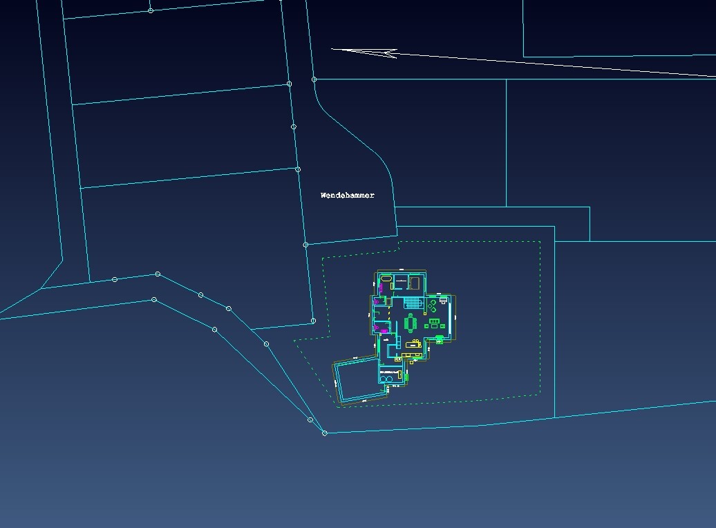

I have attached the plot of land as well.
Technical CAD drawing of a large machine frame with a small colored interior plan in the detail.

Hi,
Could you please explain the constructive criticism in more detail? Honestly, I didn’t understand everything about sight lines and opposites, etc.
It’s not a loft. I won’t be able to work on the exact details until Monday because I can only access my PC via TeamViewer, which isn’t ideal for drawing.
Many thanks!
