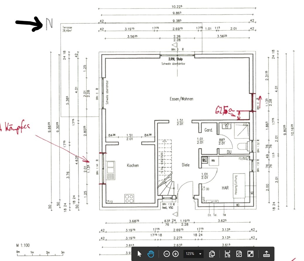

Enlarging the ground floor is not possible as we are already fully using the building envelope/planning area: building envelope 10 x 10 meters (about 33 x 33 feet) and planned house 10.20 x 10.16 meters (about 33.5 x 33.3 feet).
We want a townhouse-style villa because we do not want sloped ceilings upstairs. We currently live in an attic apartment and both grew up in attics, and we did not want that anymore, especially because of the roof windows. Moreover, the house has now been planned perfectly for us, and we would have to reconsider everything because the sloped ceilings would ruin the rooms. In my opinion, a gable roof over our rooms is not possible. I will share our floor plan; maybe you have a different opinion.
If a gable roof is the only solution, the ridge must run east to west, as the surrounding houses have the same orientation.
The possibility to store some items in the attic space is essential for us. Roof windows are a nightmare for us but probably unavoidable.
Thanks in advance for the many responses.

Talk to the building authority to see if a knee wall of 1.80 m (5 ft 11 in) or even 2 m (6 ft 7 in) would be acceptable. If so, consider a shallow gable roof on top to better match the rest. You'll have to live with the slight slope just above head height – double-check if the shower can stay as is.
By the way, isn’t the path with the shopping bags through the somewhat cluttered lounge area all the way to the kitchen a bit long for you? It wouldn’t be my choice.

Momarx89 schrieb:
since we don’t want any sloped ceilings on the upper floor That is now definitely ruled out for this plot.
Momarx89 schrieb:
in my opinion, a gable roof is not possible for our rooms Yes, it is. You could install one large dormer facing north and one facing south (I would personally prefer three smaller dormers, but that would create more sloped ceilings). The bathroom layout would need some slight adjustments.
Momarx89 schrieb:
the possibility to store something in the "attic" is absolutely essential for us. With a 10m (33 ft) wide house, a steep gable roof, and knee walls, you will get a decent attic space—certainly more than with a townhouse featuring a hipped roof.
