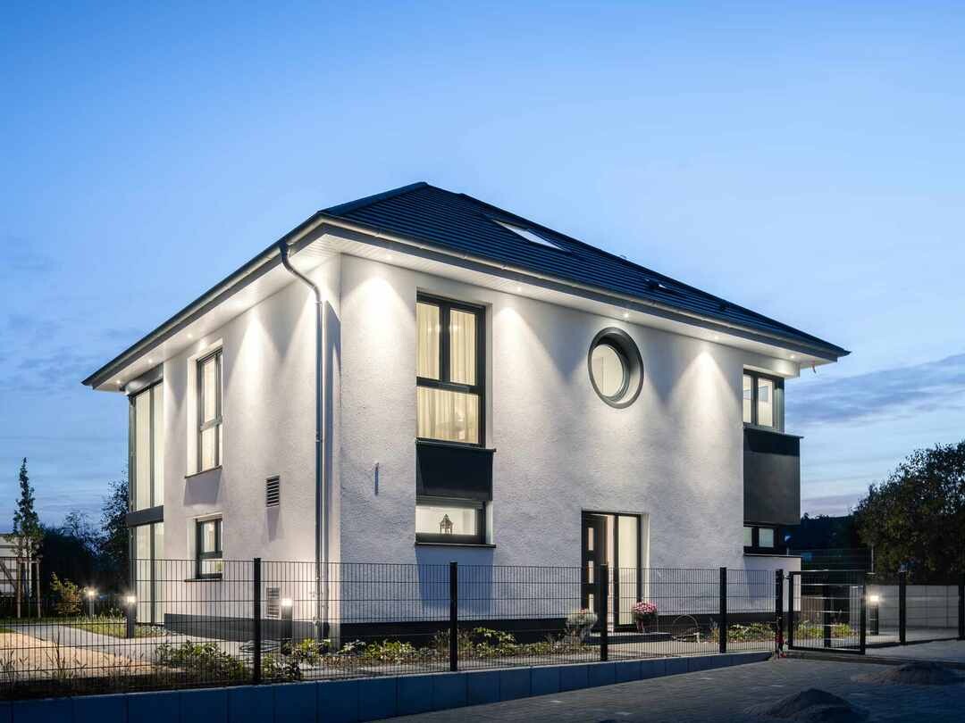

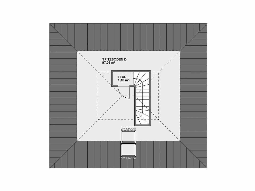

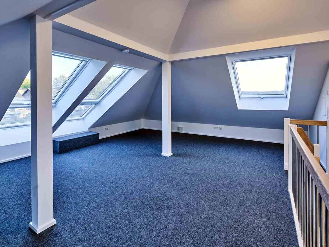

The appearance of a 10 x 10 m (33 x 33 ft) villa with a hip roof leaves much to be desired, and even with a 35° roof pitch, you need a clear concept for a knee wall to realistically consider usable attic space. Without a knee wall, I only get 11.76 sqm (127 sq ft) of room with a ceiling height of 230 cm (7 ft 7 in), whereas a gable roof offers about 2.66 times that amount. Where exactly does he plan to put the staircase? – please show the entire design.
We visited a city villa with exactly these specifications, a 35-degree hip roof as a show home, and at my height of 1.84 m (6 ft), I felt comfortable upstairs in the attic.
For better understanding, here are photos of the exterior, the attic interior, and the attic floor plan.

It still does not have an emergency exit or escape route, which is extremely negligent for a child, and on top of that, the father did not listen or simply disregarded it. But now imagine putting a wardrobe and/or a bookshelf in there... do you still feel comfortable?
WilderSueden
22 Dec 2020 12:46
First, you need to find cabinets that actually fit. There aren't many vertical walls, if I’m reading the plan correctly 😉
22 Dec 2020 13:14
WilderSueden schrieb:
First, you have to find cabinets that actually fit. There aren’t many vertical walls if I’m reading the plan correctly 😉
Exactly. It will then stand halfway into the room, creating a niche, but the effect or ambiance of an empty room is lost and it feels more like "there’s no other way."
