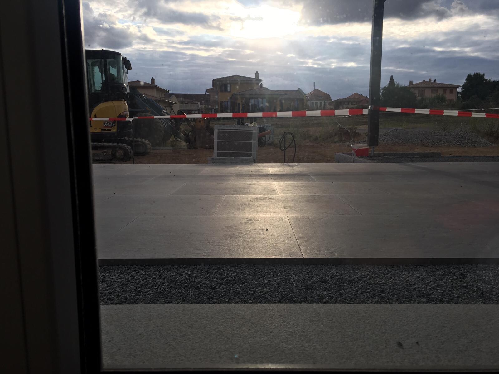

jucre45
8 Jul 2019 20:46
Well, we’ll see. So far, everything has been laid out accurately and properly, and I have to trust the professionals to some extent.
View of a construction site with an excavator behind barrier tape and houses in the background.

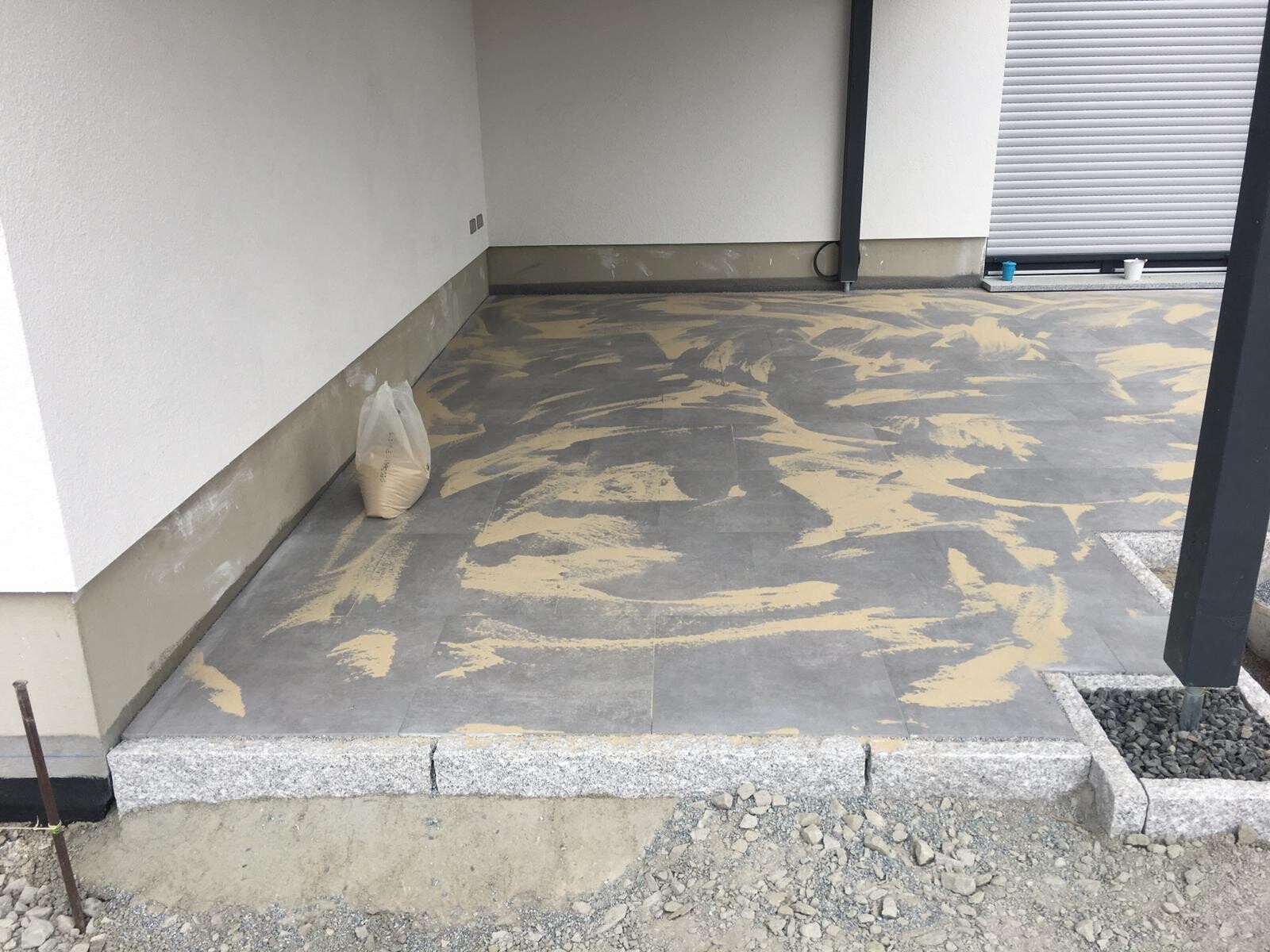

jucre45
9 Jul 2019 17:13
Finished, now we are continuing with the paths around the house.
New gray patio in front of the house, construction area with tools and portable toilet in the background
New concrete patio with granite edging in front of the house; two closed roller shutters.
Outdoor area: gray floor tiles with beige adhesive residue, construction bags lying around, roller shutter in the background.

Otus11
9 Jul 2019 18:54
jucre45 schrieb:
finished....
Of course, without drainage channels in front of the floor-to-ceiling doors, it does not comply with the standards (but it may still function).
Fortune favors the bold
guckuck2
9 Jul 2019 19:20
Setting tiles outdoors with tight joints directly onto a gravel bed and then filling the joints afterward is something I haven’t seen before either. But what matters is it turned out nice.
