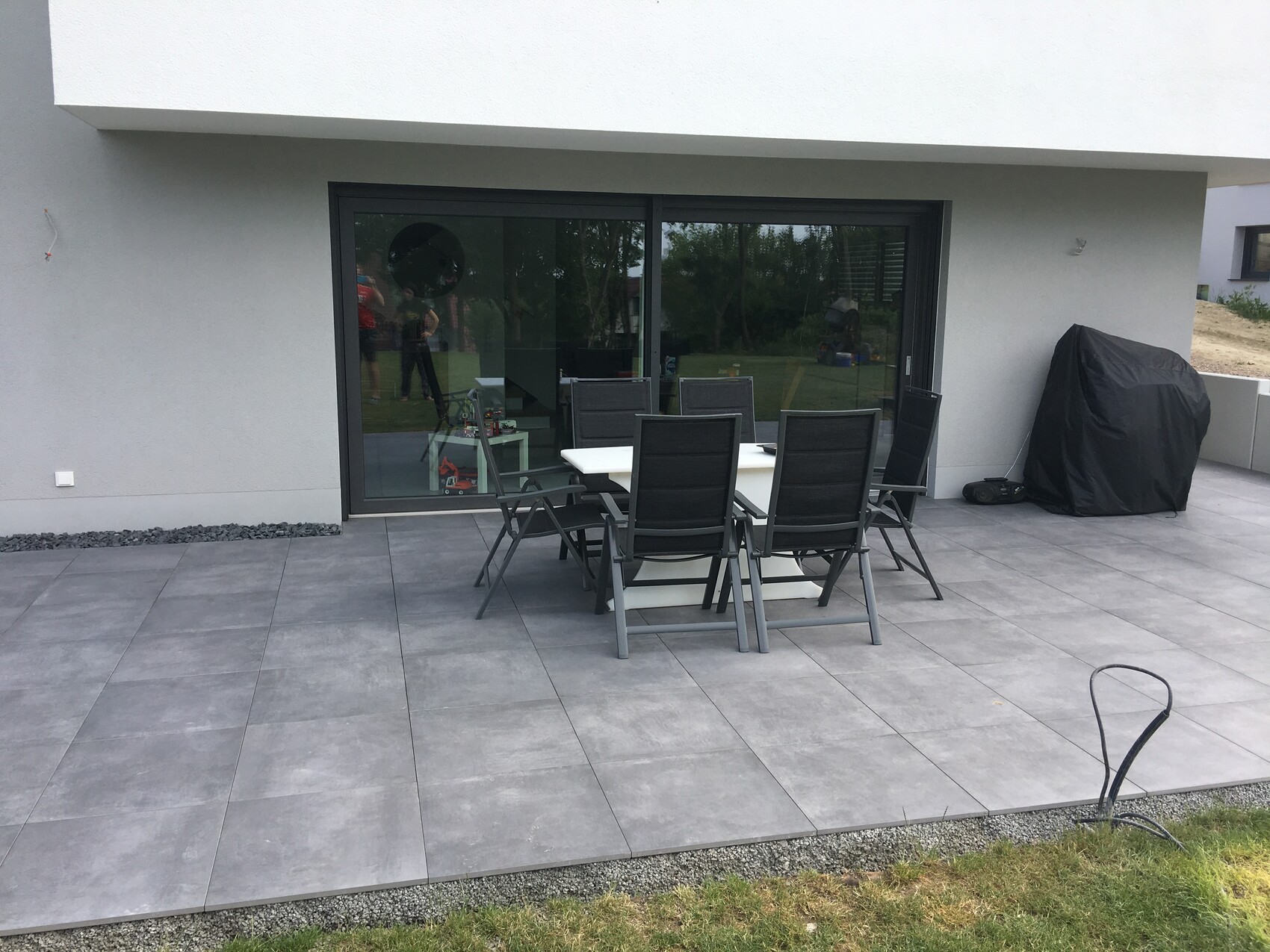

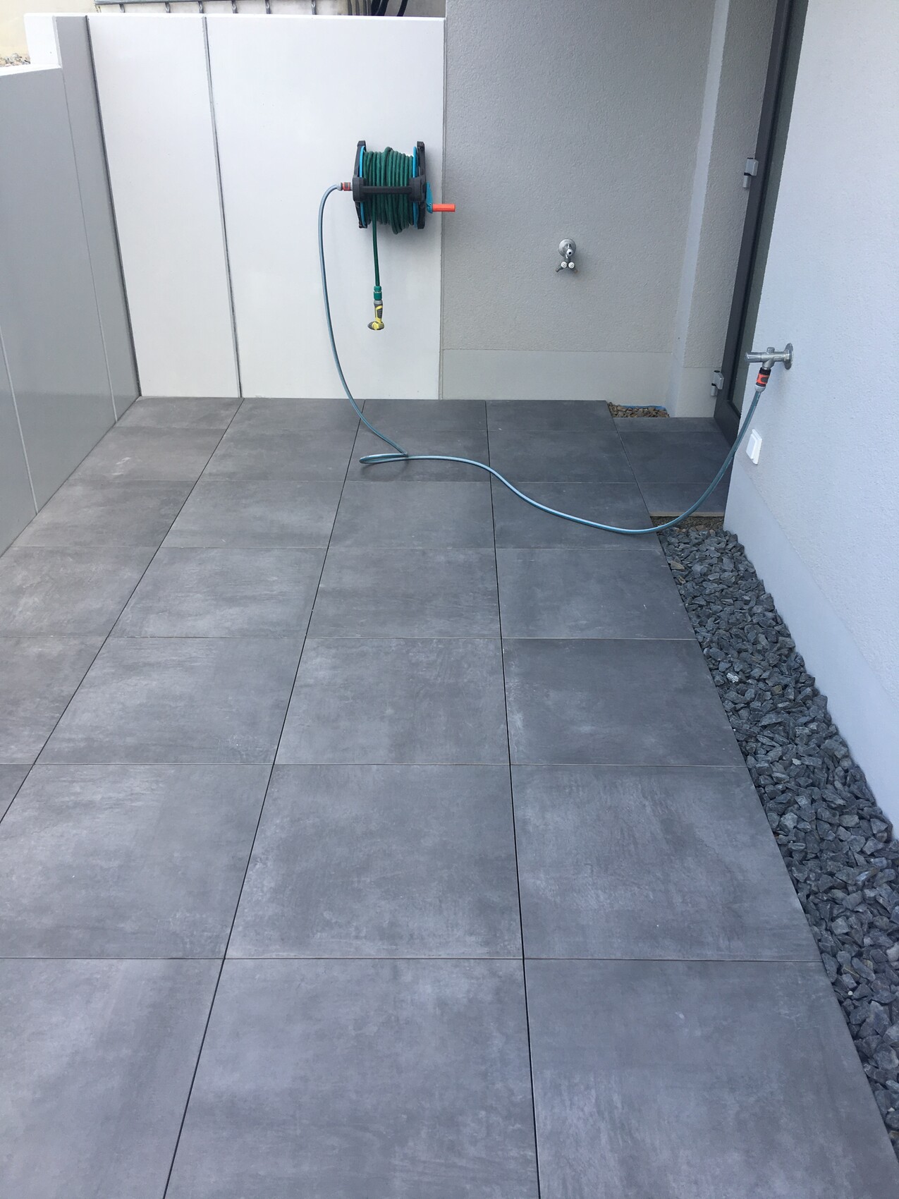

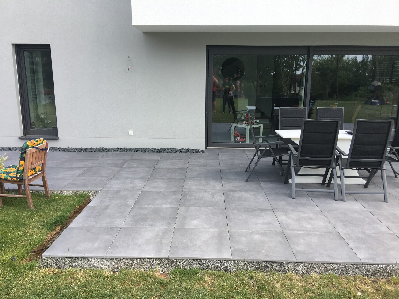

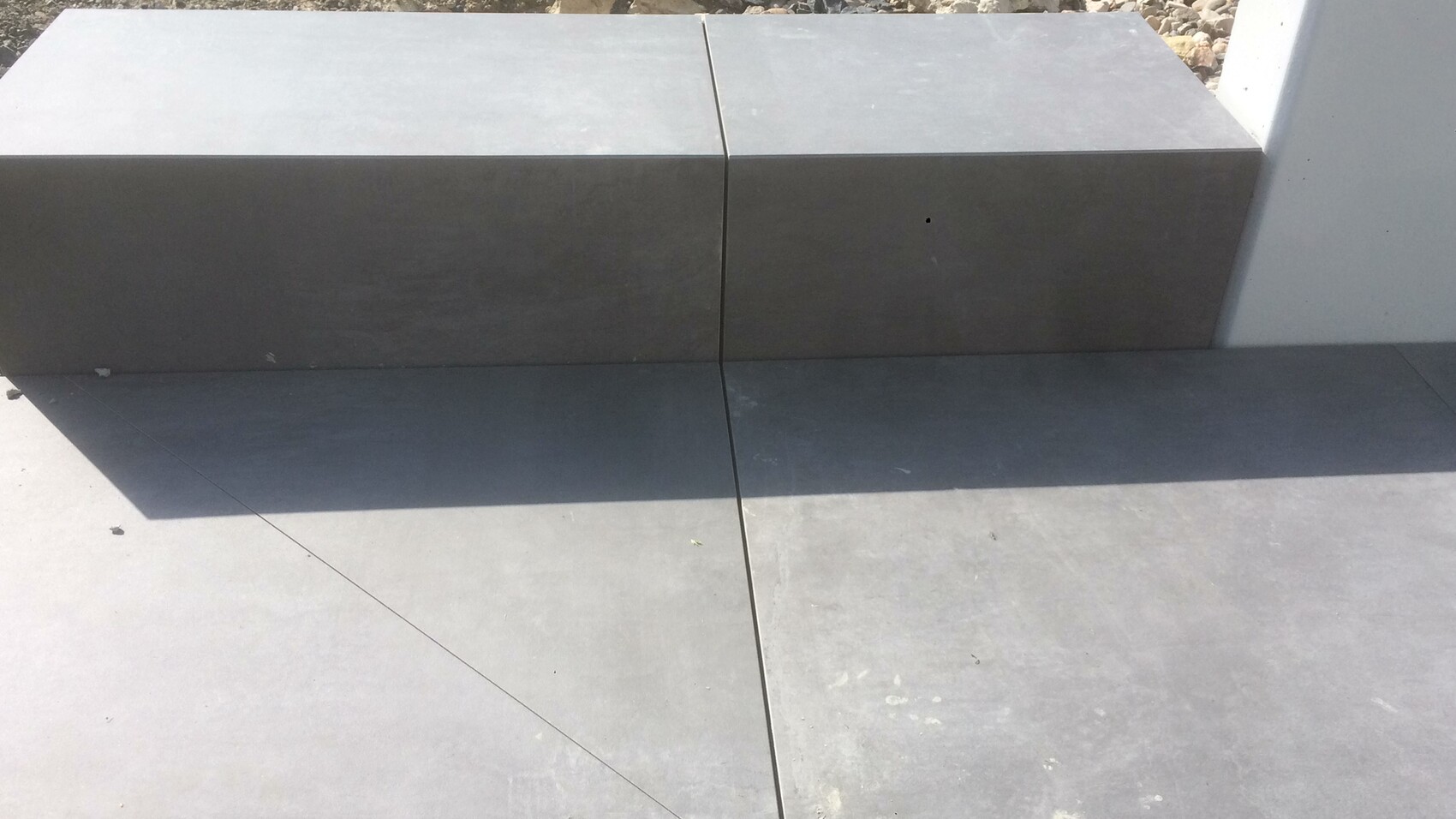

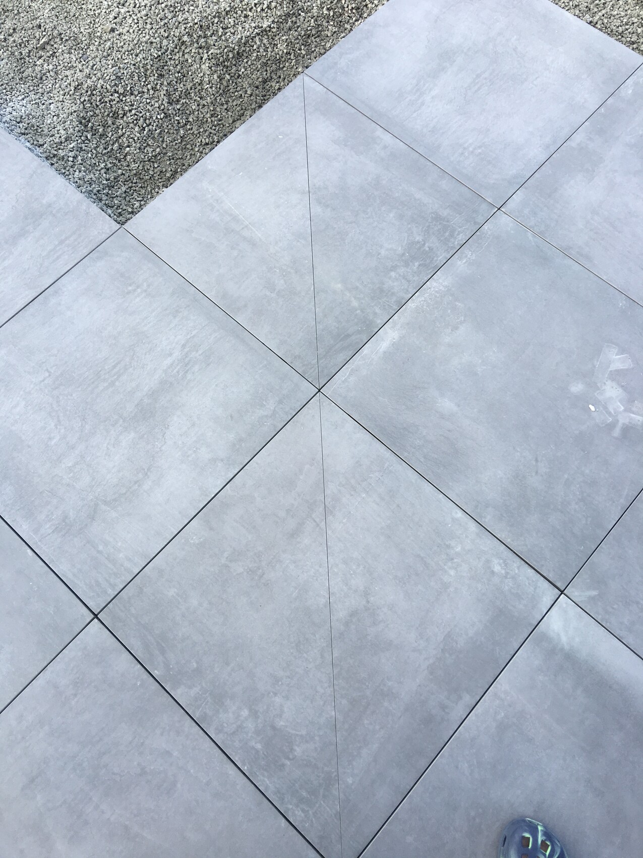

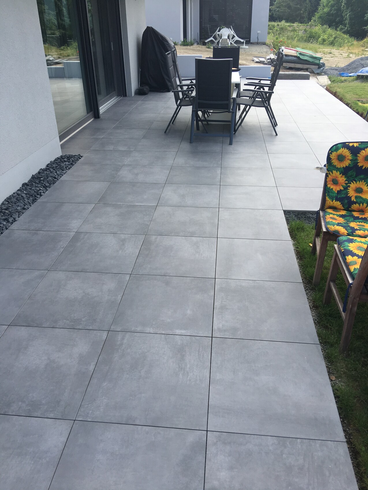

We installed 60x60 cm (24x24 inches) porcelain tiles on a drainage concrete base, covering almost 80 m² (860 sq ft)... all cuts were made using a water jet, so with a 1 mm (0.04 inch) grout joint, the cuts are barely visible. Since the terrain is slightly higher on both sides, we built two block steps from the porcelain tiles, which looks really good.

Is it correct that the connection for the Gardena reel runs along your path? Wouldn't it have been better to move the tap along with it?
