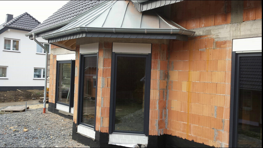

I’m about to start the exterior landscaping soon, and I noticed that the floor-level windows on the outside are not sealed properly, as shown in the picture.
What is the best way to seal them?

Outdoor area of a window frame above a dark foundation with damaged sealing.

I had already mentioned the dimple membrane; it was not included in any of the specifications, but that’s not a big issue since the house is still exposed around the edges, so it can be installed later. The black sealing membrane was applied after the windows were installed, but for some reason, they didn’t continue the material all the way around.

I checked again, and that was included with the roofers in the tender. I don’t know why they didn’t do it below the windows. It’s just unfortunate that they have already been paid, which means it will be difficult to get them back on site. This is normally sealed with bitumen, right?

I found a photo of the shell construction.
I’ll call the architect, although I’m not really keen on it, but this is a defect.
Rohbau eines Hauses mit Ziegelwänden, großen Fenstern und Dachüberstand
