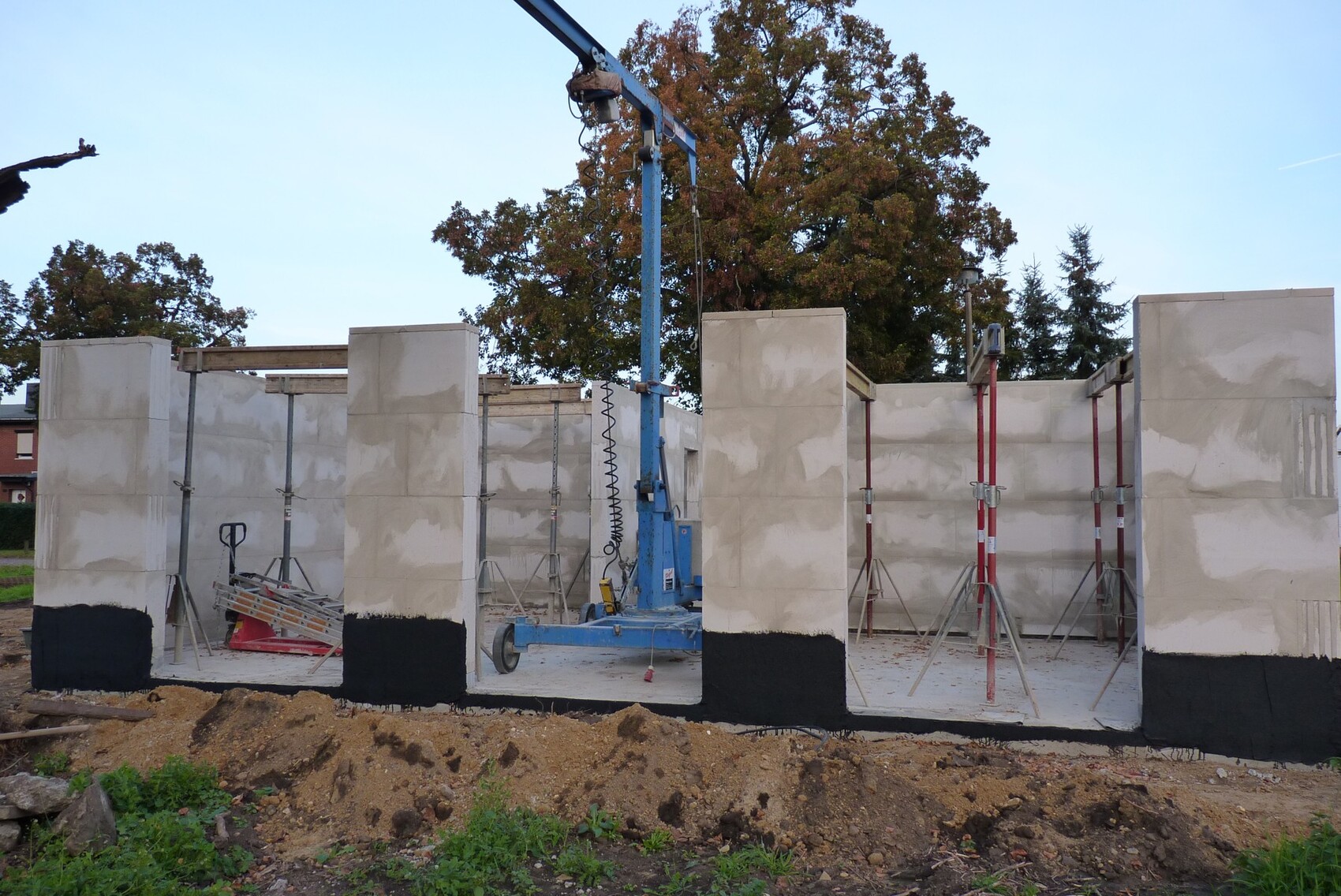

The windows were sealed during installation, except at the bottom. Bitumen was applied after the windows were installed, but the areas around the windows were left untreated for about 60cm (24 inches) in height.

Sebastian79 schrieb:
You are mistaken – waterproofing is done first, and then again at the connections after installing the windows.
Yes, you are right. First waterproof the shell, then install the window. The latter is probably usually done by the window installer?

Sebastian79
22 Aug 2016 22:38
No, I already mentioned here who usually does that 😉.
The roofer
