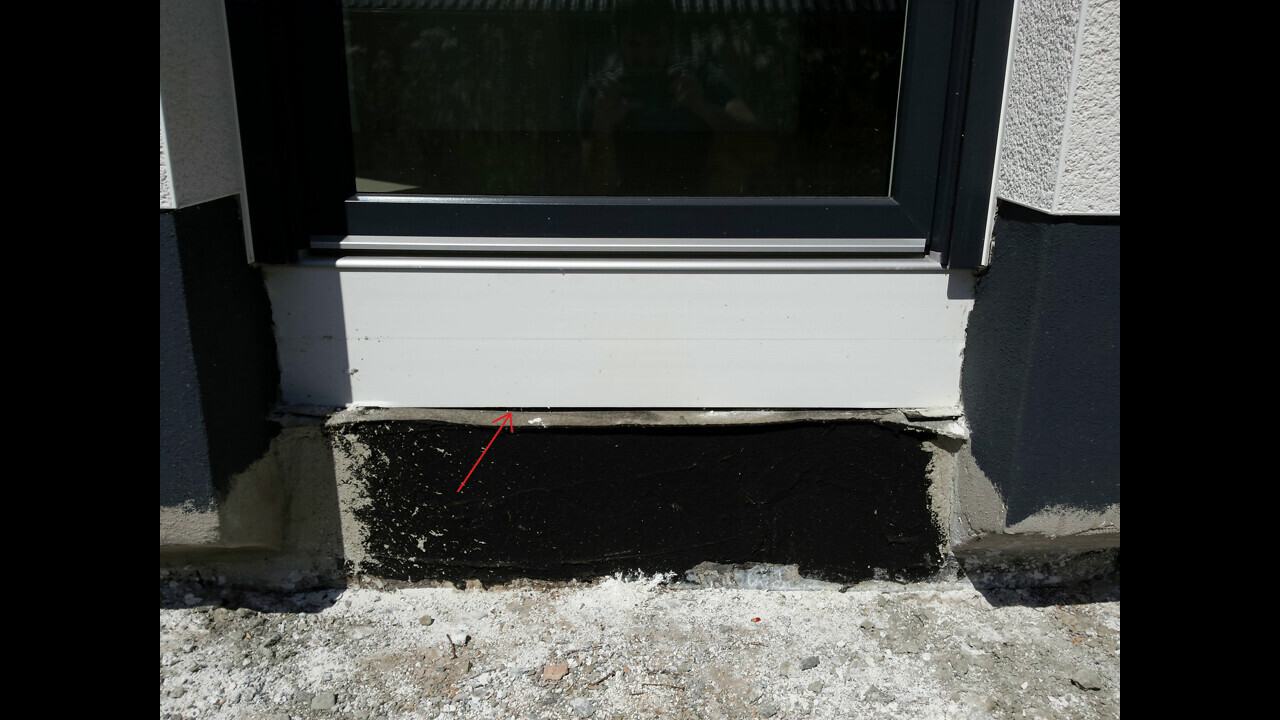

I’m about to start the exterior landscaping soon, and I noticed that the floor-level windows on the outside are not sealed properly, as shown in the picture.
What is the best way to seal them?
Thanks in advance.
Regards
Outdoor area of a window frame above a dark foundation with damaged sealing.
Bieber0815
22 Aug 2016 20:53
Was the base sealed before the windows were installed?
O
oggear51
22 Aug 2016 20:55
They didn’t participate in the window area, but I don’t know why.
Sebastian79
22 Aug 2016 21:07
Why not before? That is correct after all..
O
oggear51
22 Aug 2016 21:11
I can’t tell you that; probably only the architect knows.
Bieber0815
22 Aug 2016 21:35
oggear51 schrieb:
ne danach
Yes, that’s how it looks ;-). How can you properly seal it if the windows are not yet installed when the sealing is done? Why doesn’t the person responsible for sealing raise any concerns? What was the site manager doing during that time? Who approved the work? Head --> wall... This confirms my humble experience that most problems simply result from poor scheduling and coordination between trades.
Sebastian79
22 Aug 2016 21:37
You are mistaken – sealing is done beforehand and then again at the joints after the window installation.
