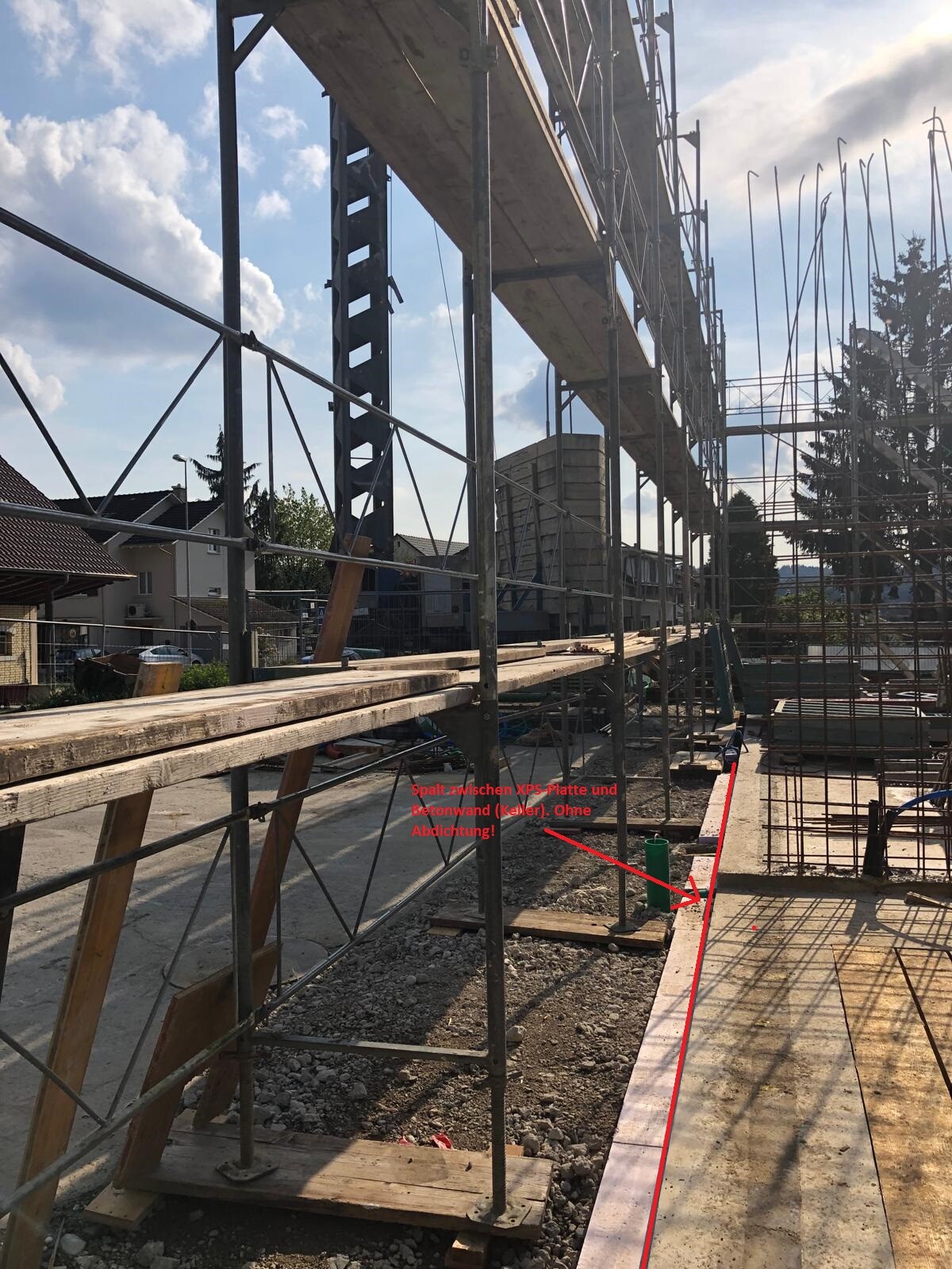

The plumber was on site the day before yesterday and installed roofing felt around the house for waterproofing. During this, it suddenly became apparent that on the front side of the house (20m (66 feet) long), no waterproofing is planned at the junction between the old basement ceiling and the new slab. Likewise, no horizontal damp-proof course has been installed. Currently, XPS insulation boards are placed directly against the unprotected concrete wall (not glued) and everything has been backfilled! The gap between the XPS board and the concrete wall is also not sealed. See photo!
Furthermore, it should be noted that this area is a garage driveway and vehicles will drive over the XPS boards. According to the builder, this detail can be solved with a steel angle above the XPS board. But how do you seal something like that?

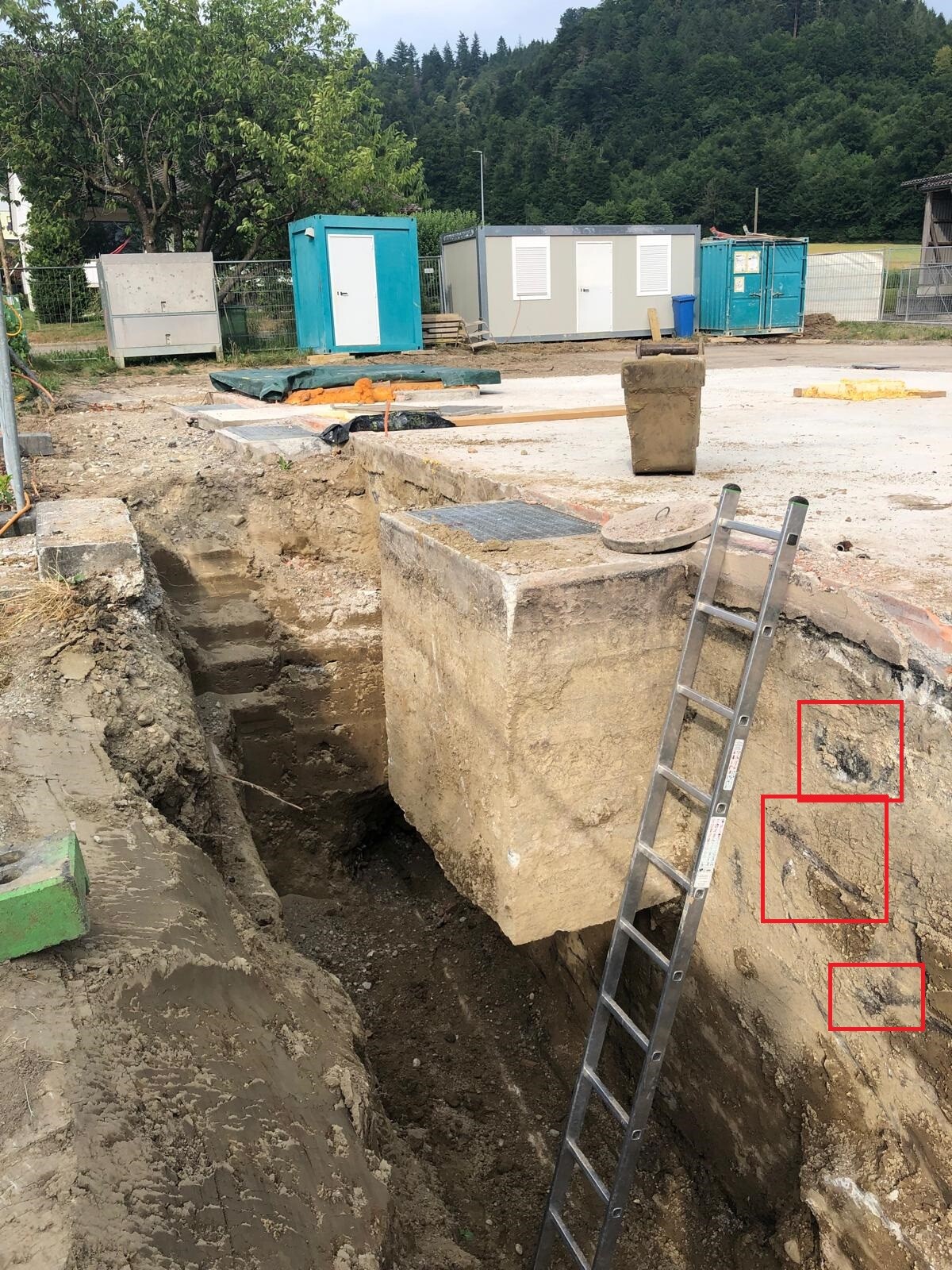

The issues continue. Excavator work was also done deep along the entire rear side of the house (also 20m (66 feet) long). I wonder if the existing waterproofing on the basement walls (bitumen) has possibly been damaged by the excavator work and if there is a further problem there (see attached photo). No XPS boards were installed along this wall; as shown in the photo, it has simply been backfilled.
When I confronted the architect about this, the response was: "No water will get in; there is still an asphalt layer above. But if you want it, you can have it!" When I then explained that capillary action can draw in water, which can freeze and cause the concrete to crack, he calmed down a bit and said, "It’s only a basement!" (The junction to the old basement ceiling is about 20cm (8 inches) below ground level, so not frost-protected!)
