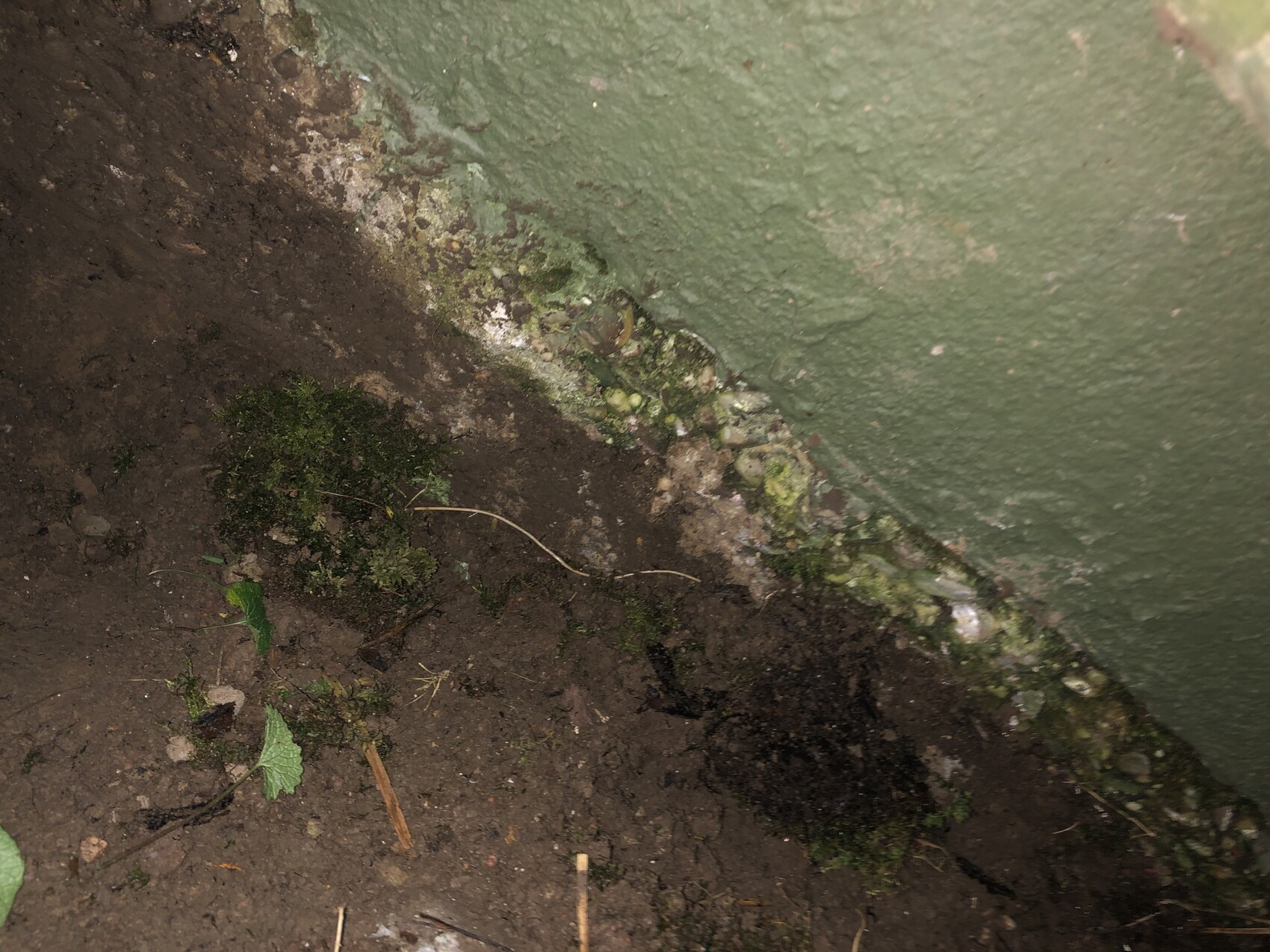

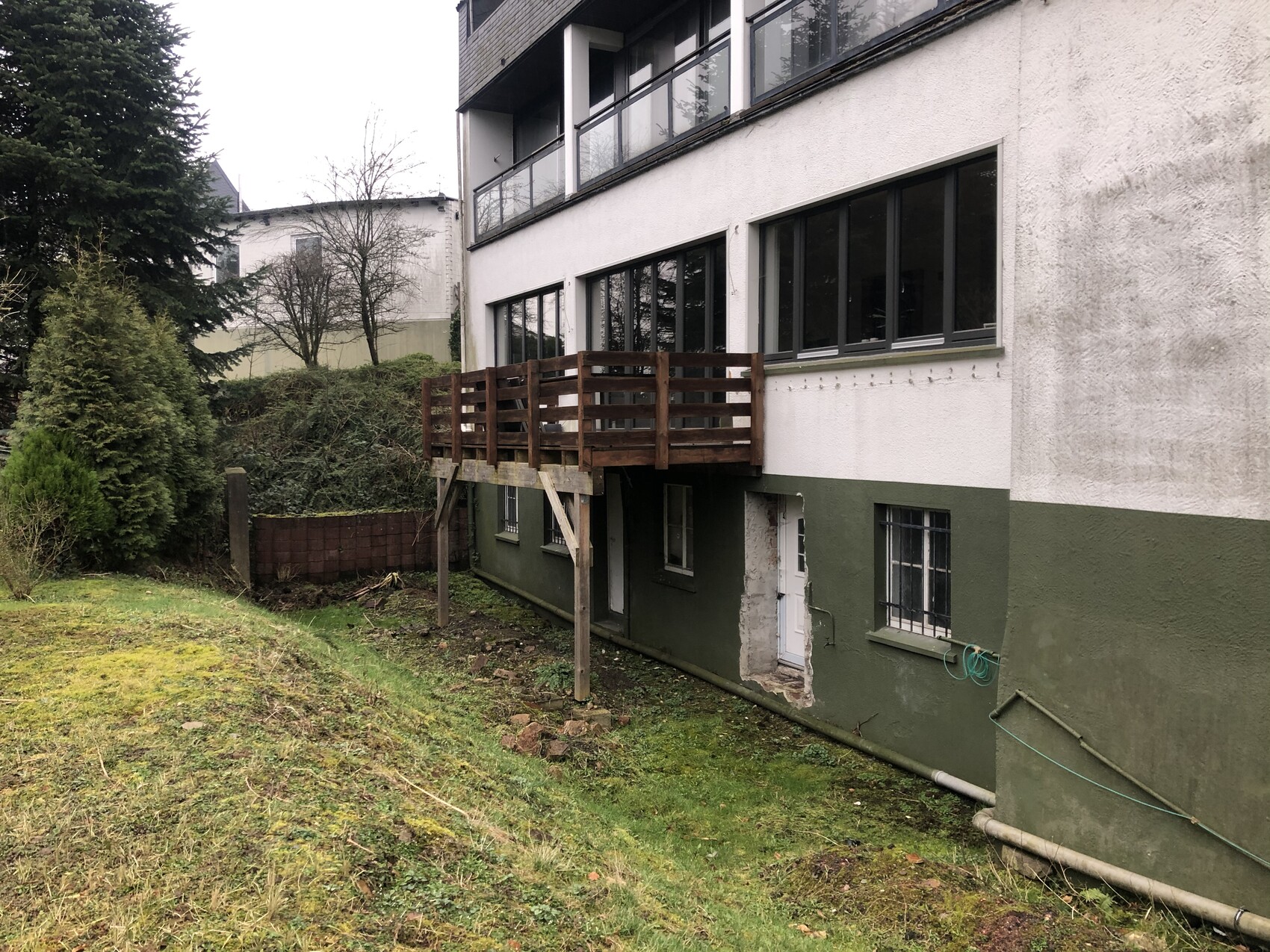

I want to backfill the rear of my house/lot as part of the facade renovation to match the surrounding ground level, dismantle the small balcony, and build a proper terrace.
Since the basement walls are now exposed, I have the opportunity to waterproof them with a thick coating. Now I am working on the detailed planning. I have excavated about 30-40cm (12-16 inches) below the existing ground level and apparently found the foundation.
Is this a rubble stone foundation or a strip footing that has been backfilled with stones/gravel? How should the coving be formed here, since I don’t have a classic upstand at the connection between the slab and the strip footing, and I plan to apply the thick waterproofing about 15cm (6 inches) below the underside of the slab (as I am used to)? As shown in the pictures, the slab is at the same level as the entrance door.

Hello, you can already find quite a few detailed explanations on this topic using the search function. But here’s a quick summary. It currently looks like an old concrete slab. So you need to expose it, level the surface (a thin layer of plaster), and then waterproof it using a system (there are various options available at building supply stores) applying two layers. Then install a studded membrane, add drainage, and finally backfill.
