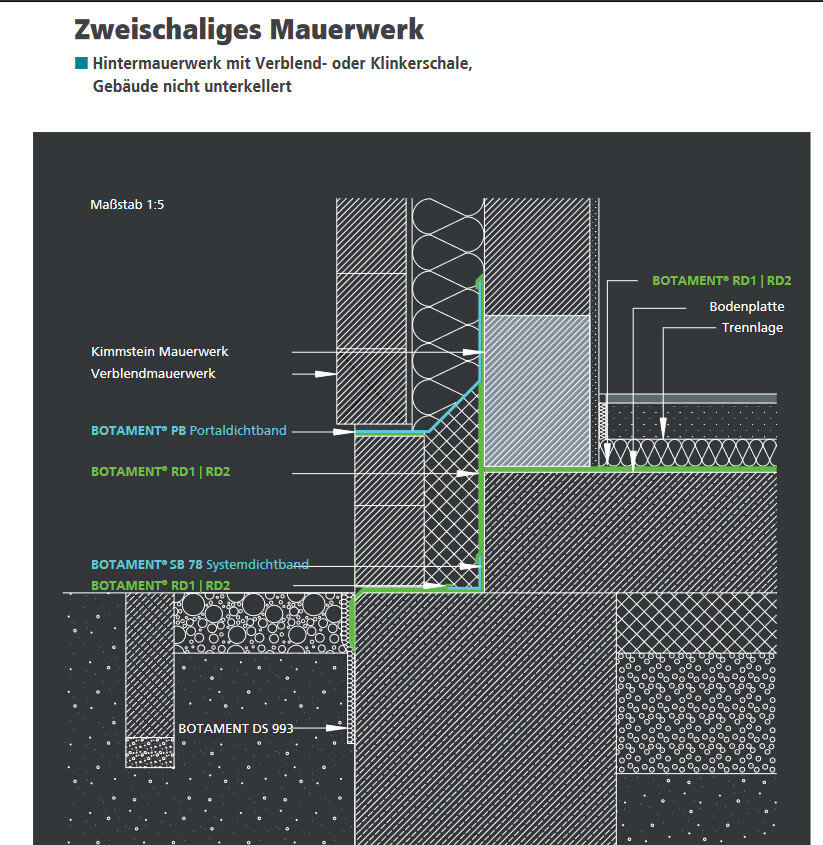

I believe your house is built too low in the terrain, and the waterproofing of the house was done poorly. The first is a planning error; the second is poor workmanship. Now they want to fix the poor workmanship by just applying something to the outside. That will not work.
This is how it should look, for example. The details may vary slightly depending on the manufacturer, so have your builder provide the appropriate specifications. You are entitled to this because the builder owes you a construction according to the manufacturer’s guidelines and the recognized rules of technology, which you can only verify with the detailed documentation (by having it checked).
