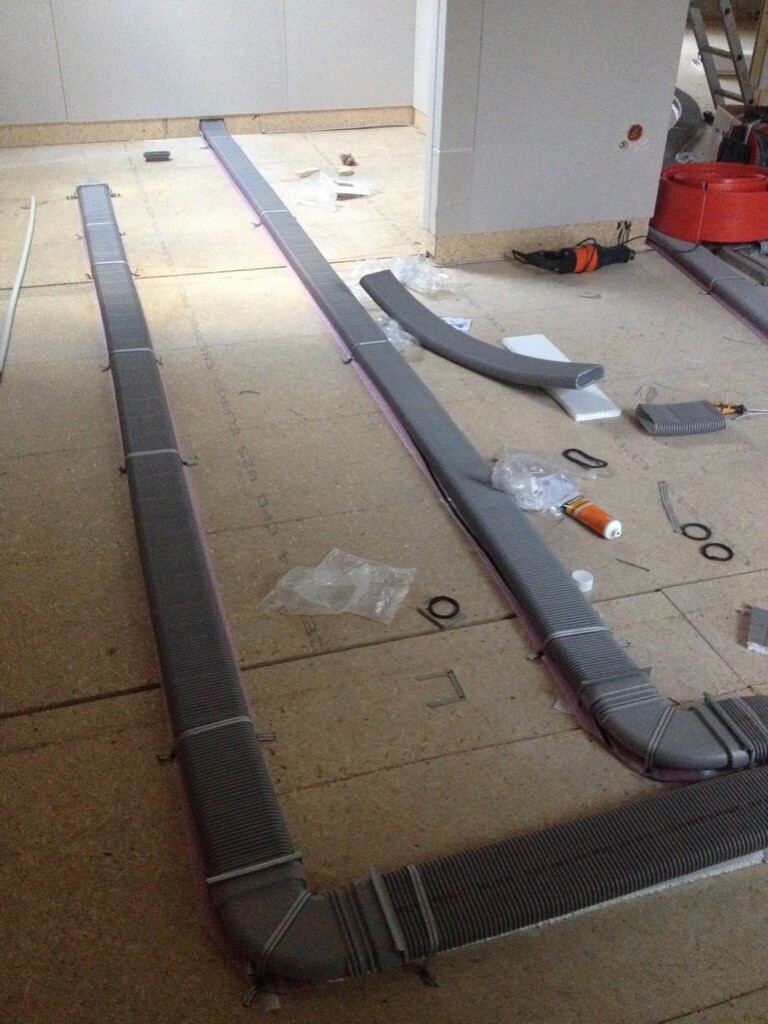

Hello.
In our new build, flat ducting for the ventilation was installed under the screed. This was part of the original plan. (So it must be a common method.)
I cannot say whether this might cause any noise problems; we are still living in the rental apartment.
This is our bedroom before insulation and screed.

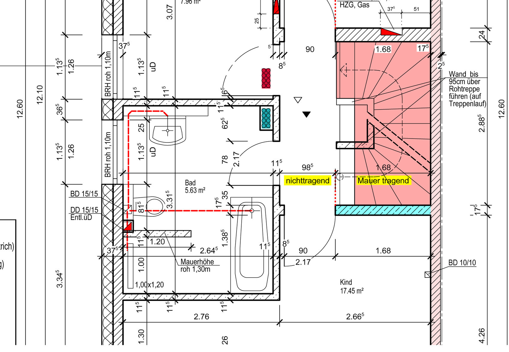

Bieber081527 Oct 2016 21:13To understand this, one would need to see the (original) ventilation plan showing the location of the incorrect openings.
