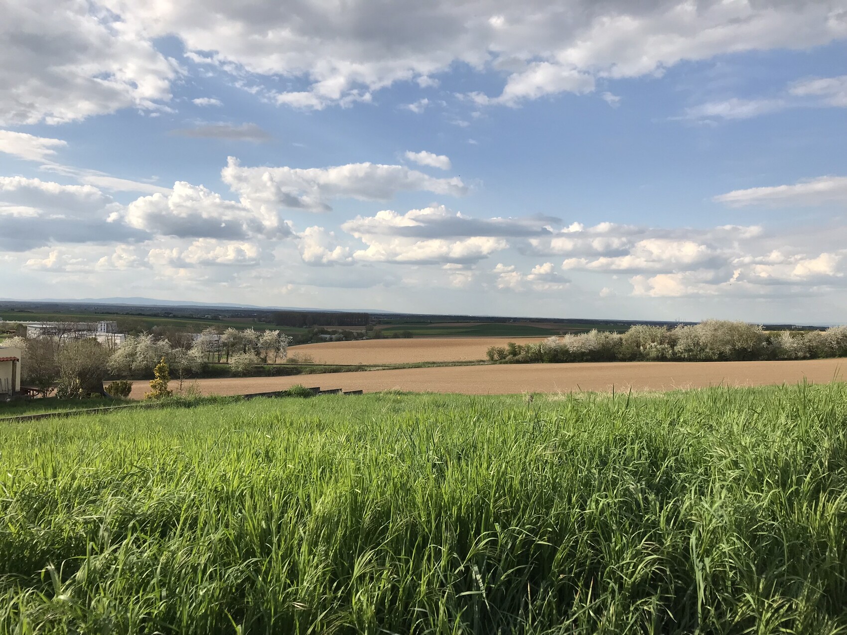

Specifically: I feel the decision about the view is final. A closed-off kitchen to the north near the terrace blocks the view. So, as the client, I want the living room to face north.

Some earth needs to be built up to the north, while the slope to the west is suitable for nice windows.

Really nice view – but how certain is it that no new housing development will be approved there in the next 10 to 20 years?
And then? No more view, or just a view of the new neighbors’ roofs, but a dark living room instead. Congratulations!
Unfortunately, this is always a risk. I still clearly remember an acquaintance of my mother who proudly showed us her new house with the (admittedly) phenomenal view from the living room. When my mother remarked how unfortunate it would be if something was built in front of it, she replied confidently, “Nothing will be built there anymore; the mayor promised!”
Three mayors later, this house is now in row 7 or 8, and the view can only be seen in old photos...
Lessons learned: Build your house so it works well even without a view. A nice view is a pleasant bonus but should not be the main focus of your planning. For most plots, the view is never guaranteed forever.

Climbee schrieb:
Build your house so that it still works even without a view.I always say: do you spend all day just looking out the window, or what?
I work during the day, and for about a third of the year, when I’m at home in the evening, it’s already dark outside.
And in summer? I’m working then too… and when I’m home, unfortunately I still have plenty of daily tasks to take care of, some gladly even voluntary. Peeking out the windows now and then: gladly, especially towards our garden beds, our patio, or the arrangement in front of the patio door. And when I’m outside, I sometimes wander around the property, fiddle with the plants, admire everything, try out the benches in every corner of the lot, and eventually close my eyes while lying on the lounge chair.
So, having a view is nice to have, but the sun is more important. (no light means no view 🙂 )
However, here in the north, the building setback line already divides the garden anyway...
