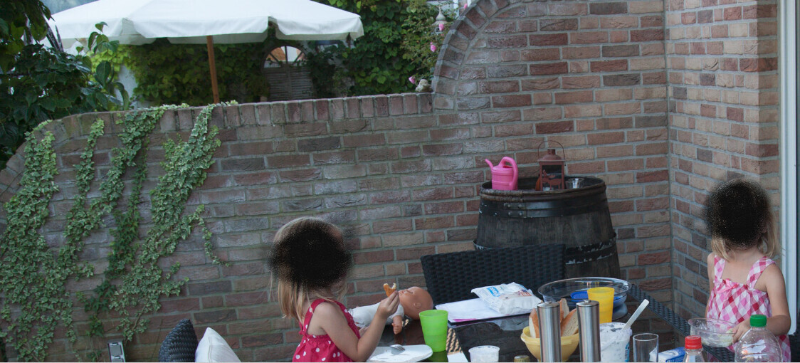

C.beckmann19863 May 2021 19:19What about these concrete fences? They are probably “worse” than a thick wall, but better than those WPC panels with an open bottom, right?
We have brick cladding, and the middle wall is also brick-faced.
Since both we and the neighbors have the garage slightly protruding on the outside, our patios are now somewhat recessed. Cozy. And no, we didn’t want the wall built all the way up to the roof, as we wanted some airflow.
After two summers, we still like it. Of course, it’s not soundproof, but we have our own conversations and don’t need to eavesdrop on the neighbors.
