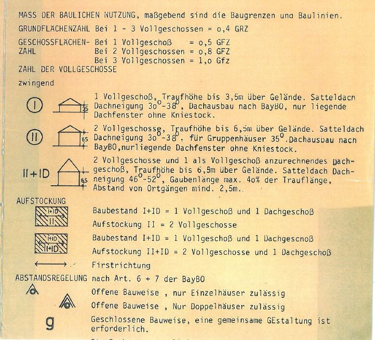

The development plan states the following...

This amendment was recently approved:
Document with text on development plan amendment and construction project, legal regulations
Honestly, I don’t understand the connection between the eaves height of 3.50 meters (11 ft 6 in) and "no knee wall."
Wouldn’t that almost mean a ceiling height of 3.50 meters (11 ft 6 in) on the ground floor? Who wants that…

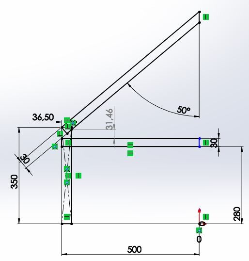

If I only have 2.80 meters (9 ft 2 in) height and use up the 3.50 meters (11 ft 6 in), then I have a knee wall.
Here is my understanding...
2D floor plan with dimensions, 50° roof pitch, interior walls, and door symbols
Knee wall marked in GRAY!!
Please clarify.
Thanks!

Exactly (I) applies.. But it hasn’t been purchased yet.. We are currently having some plans drawn up..

16 Oct 2016 18:21
without knee wall refers to the window – horizontal windows, such as roof windows, do not have a knee wall, while dormer windows do 🙂
That is also why there was a change in 1990.
That’s how I understand it 🙂
Der-w
16 Oct 2016 18:23
Well, that might be the case.. Although then the 3.50 meters (11.5 feet) would also be too low :-) you only have 30 cm (12 inches) knee wall height if I calculated it correctly.
Bauexperte
17 Oct 2016 01:33
Der-w schrieb:
Well, maybe..
Not "maybe" – Yvonne understood it correctly 😉
The 1990 amendment allows you – with a roof pitch of 40° – to have a transverse gable, which gives you up to one-third of the eaves length with full standing height.
