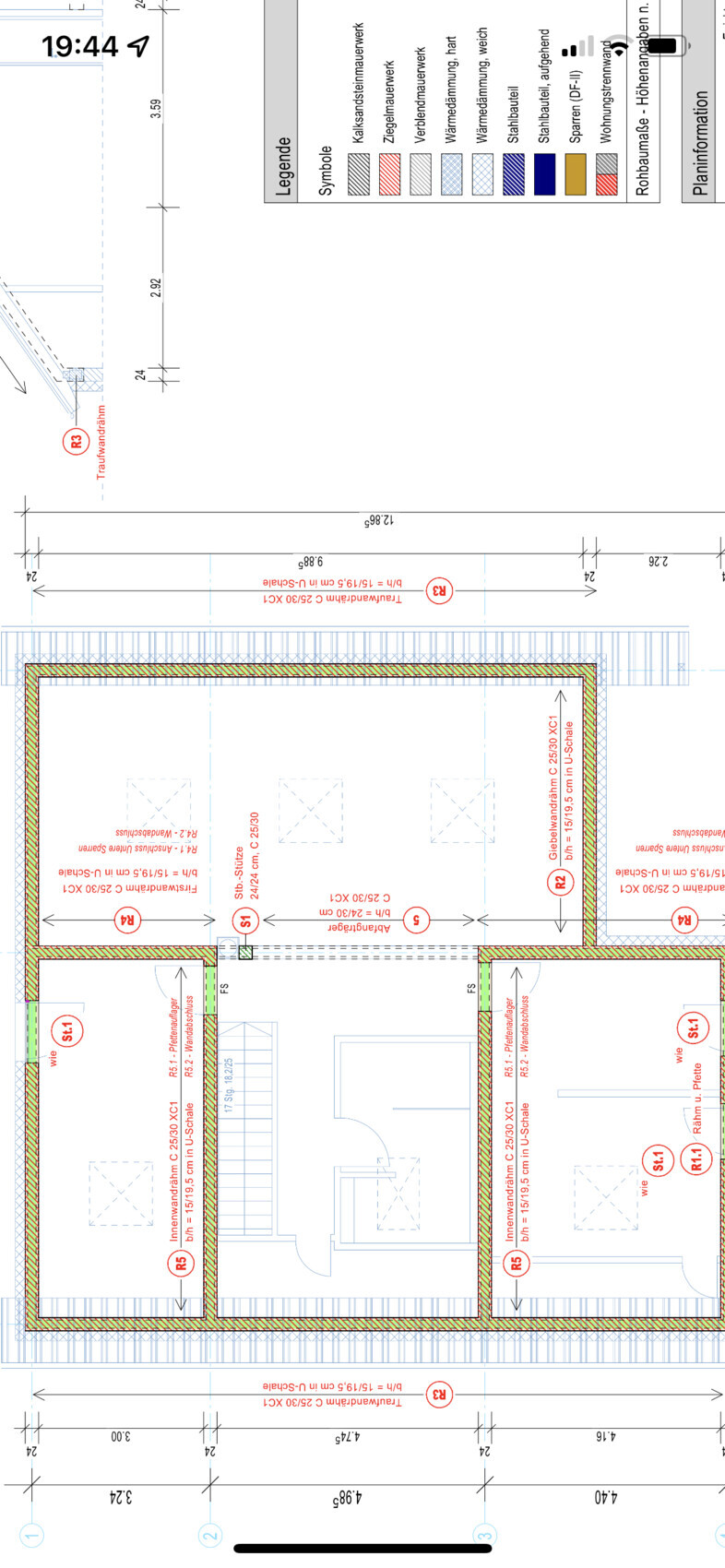

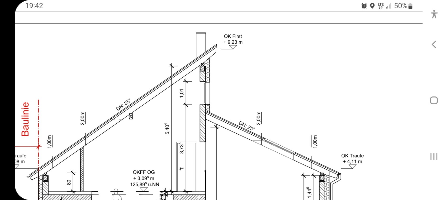

Now, we handed everything over to a construction company to build our shell. Our contractor noticed errors in the structural design (for example: the chimney passes through the upper ring beam and other issues). Keep in mind that the structural engineer has already been paid.
Our contractor had to make changes to the drawings as well as to the structural calculations! As a result, this will lead to additional costs for us.
Do you think there is any way to take action regarding this? Money has already been paid, so one would expect that the plans are reliable and everything is in order for us.

Benutzer 100120 Jun 2022 19:31A ring beam rests on the wall, so how is the chimney supposed to pass through it?
Even if you are no longer working with the architect, the creator of the structural stability report remains responsible for their work. In my opinion, taking action against them is the wrong approach, and before making any demands, you should give them the opportunity to make corrections. So: get in touch and point out the errors.
