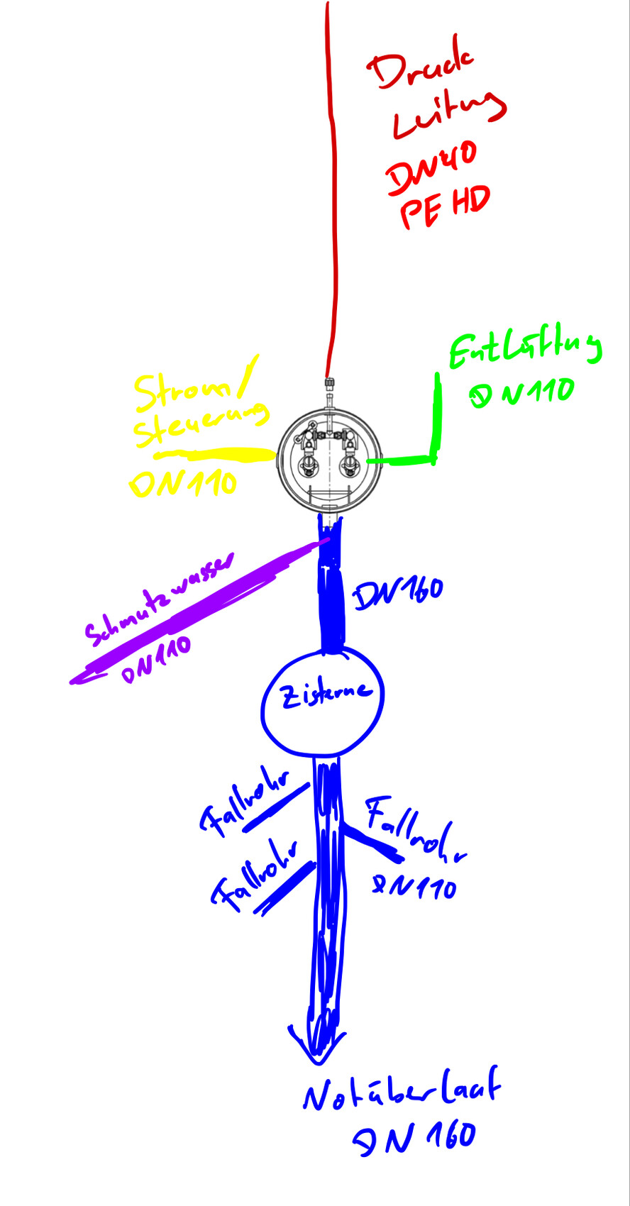

You just need to make sure that there is no pump chamber below the backflow prevention level in the supply line. Maybe that’s what the city means? By the way, the pump itself is not a backflow preventer because it is not permanently screwed to the riser pipe. It is only placed on top and seals against the riser pipe by its own weight and gasket. (At least with Jung models.)
Which chamber are you using? Are you doing it yourself?
My pump chamber has an inlet with DN160, which then splits directly into DN110 wastewater to the house, and DN160 continues to the overflow of the cistern (rainwater storage). The inlet to the cistern with DN160 is connected to the downpipes DN110 (house + garage). One inlet is oversized (DN160) and also serves as an emergency overflow.

Rainwater also through the pumps? The title only mentions wastewater.
The overflow from the cistern flows into the shaft, not the other way around.
No, mine has an inlet with a branch directly behind it; DN160 continues through, DN110 branches off. Here’s a quick sketch. No idea if it’s the same with the individual system.
