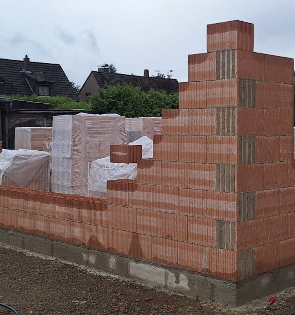

Dear forum,
Today, construction of the walls (Poroton) started at our site. The exterior walls were partially built but not covered afterwards, even though it has been raining continuously. Is this a problem, or are we worrying unnecessarily?
Thank you in advance for your assessment!
Brick wall under construction, red bricks stacked on a building site.
Allthewayup
7 Jul 2025 21:49
As long as the bricks are unfilled, this is not aesthetically pleasing but, to my knowledge, does not violate the installation guidelines provided by the manufacturers of such bricks. If the bricks are filled, you should ask your contractor in writing to cover the bricks during unsuitable weather or at the end of the workday.
wiltshire
8 Jul 2025 00:49
Bau_Schmitty schrieb:
The exterior walls have been started but were left uncovered despite continuous rain. Is this an issue, or are we worrying unnecessarily?
Leaving them exposed is negligence. I would call and summarize the conversation about this via email.
schubert798 Jul 2025 06:24
It does not harm the brick if it is not filled.
wiltshire
8 Jul 2025 09:02
schubert79 schrieb:
It doesn’t harm the brick if it isn’t filled.
The brick absorbs water and can dry out again. There is no direct damage. However, it is still poor workmanship, so I would note that accordingly.
andimann8 Jul 2025 11:32
when I look at the cut bricks on the corner, they seem to be filled with mineral wool. This should not get wet. In other words, this is now a bigger problem.
