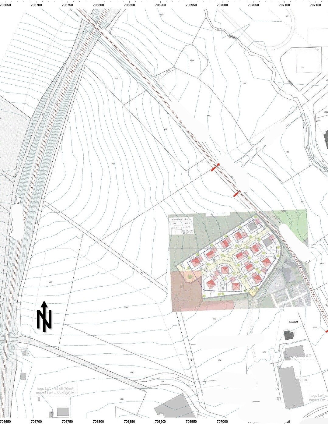

Seb_Opf
26 Feb 2022 17:38
Nida35a schrieb:
Do you already have a floor plan with orientation and placement on the property for us?
Here is a north-oriented map...
We have parcel 9 but will orient the building like on parcel 10.
The garage will be placed on the right at the boundary. We are currently waiting for floor plan proposals.
Topographical site plan: streets, contour lines, and development area with settlement inset
