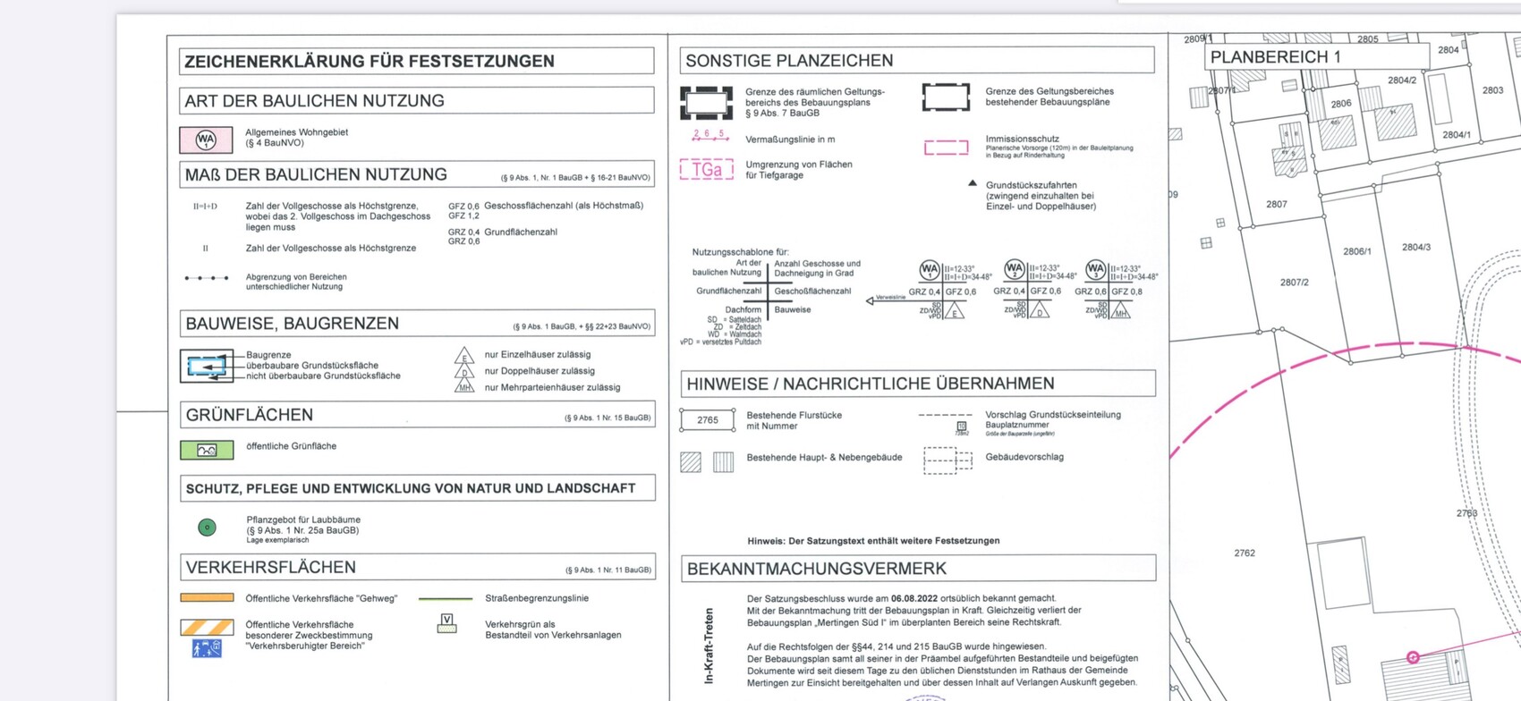

we have been invited to a meeting with the mayor because we have the opportunity to purchase a plot for a semi-detached house in our hometown.
Before the meeting with the mayor, where the other interested parties will also be present, I already have a few questions.
We like plot No. 14 the best, as it is relatively large for a semi-detached house, it is not opposite the blocks (No. 3 & 2), the access road is on the other street (blue arrow), and it is therefore somewhat more separated from the semi-detached neighbor.
However, it is on the “wrong” sunny side and does not get any southern sun. The site plan is oriented north.
- Which plot (No. 14 - 17) would you choose and why?
- Is the ridge direction specified in the development plan / building permit? The houses drawn with dashed lines are only a building suggestion according to the development plan. Or am I missing something here? We would prefer a semi-detached house with parallel ridge lines. Similar to a “gable roof 209 from Einsteinhaus.”

Bajuware93 schrieb:
The previous construction phase of the new development area was completed about 6 years ago. The apartment buildings there also include an underground parking garage.
Does this affect you in any way?B

Plot 14 seems to have the best chance of having a nice garden in the northwest. In the others, the only green space is mostly taken up by the driveway. So yes, I would also choose plot 14.
What does the black dotted line mean? Can you place the garage directly next to it? According to the zoning plan, the black dotted line indicates a “boundary between areas of different use.” I believe it marks the division between a semi-detached house, a single-family home, and a multi-family dwelling.
To my layman’s knowledge, the garage could be placed up to the boundary. It’s odd, however, that this wasn’t shown on the plan.

Rübe1 schrieb:
Development plan, section C point 2.3: Semi-detached houses in WA2 must be congruent. Well researched or carefully read.
Bajuware93 schrieb:
Do you think such a house is even feasible according to the development plan? ... I’m a bit lazy when it comes to reading other development plans, since I’m neither the architect nor the client.
Bajuware93 schrieb:
and the lack of southern sunlight must be compensated by many windows. which, in turn, contradicts the requirement for congruence, unless the building partner agrees as well. I really dislike this congruence requirement. Since I’m somewhat lazy with reading, I’ll ask whether the ridge directions are specified. @Rübe1?
If you like zigzag houses, are you aware that choosing a 14-meter (about 46 feet) plot means you’ll have little benefit from that if you access the lot from the north?
