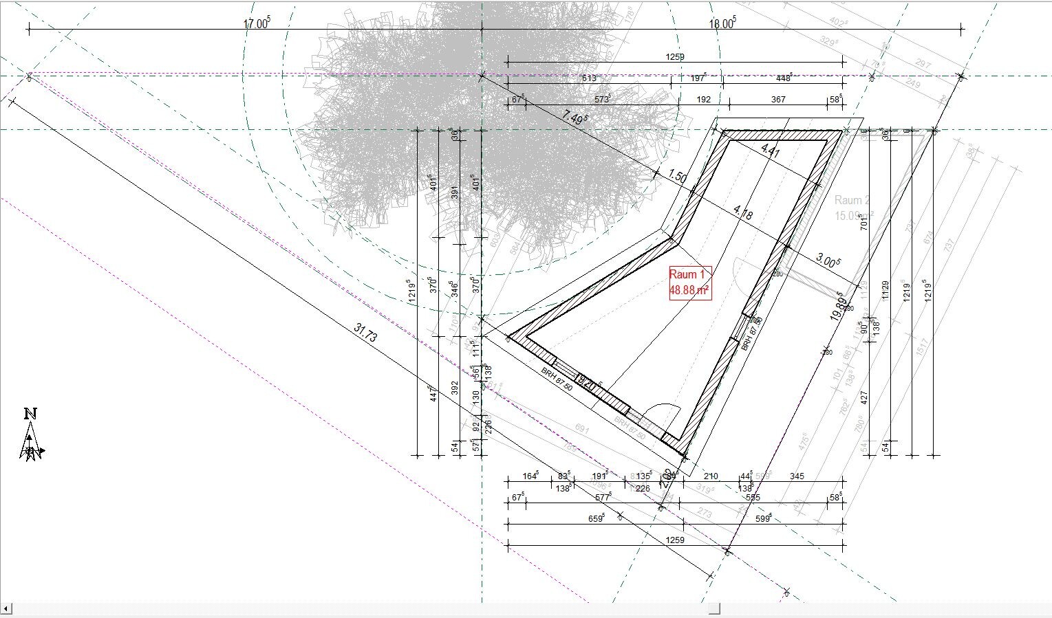

Take his plan from #38, get his plot from TIM-online, fit the plan in, and you’ll see there’s about 4 meters (13 feet) of space (+/- 50 centimeters (20 inches)) beside the tree, increasing toward the street. The garage fits in the building line, far enough from the street to allow a usable driveway including windows for the basement to be built. If he has enough money, he can use micropiles in the tree’s root zone, avoiding at least the safety distance, which by the way isn’t even mentioned in the tree protection regulations.

Take his plan from #38, take his plot from TIM-online, fit the plan in, and you’ll see there’s about 4 m (13 feet) of space (+/- 50 cm (20 inches)) next to the tree… I’ve already tried that. We don’t know the exact measurements. But in my opinion, the aerial photo with Mottenhausen’s sketch is more accurate than the original poster’s drawing. It should be a building with a maximum width of 4 m (13 feet) – probably less. Depending on the exact position of the tree, the depth is also very limited.I’m not saying it’s impossible to build something there, like a garage, for example. But I don’t believe the original poster will spend several hundred thousand euros on some kind of tower.

Take his plan from #38, take his plot from TIM-online, fit the plan in, and you’ll see there is about 4 m (13 feet) of space (+/- 50 cm (20 inches)) next to the tree, increasing towards the street. Go to Google Maps and switch to Satellite view.
Right-click on a starting point. In the menu that appears, select "Measure distance." If you now measure the important dimensions, you will realize that Mottenhausen is closer to the truth than the OP.

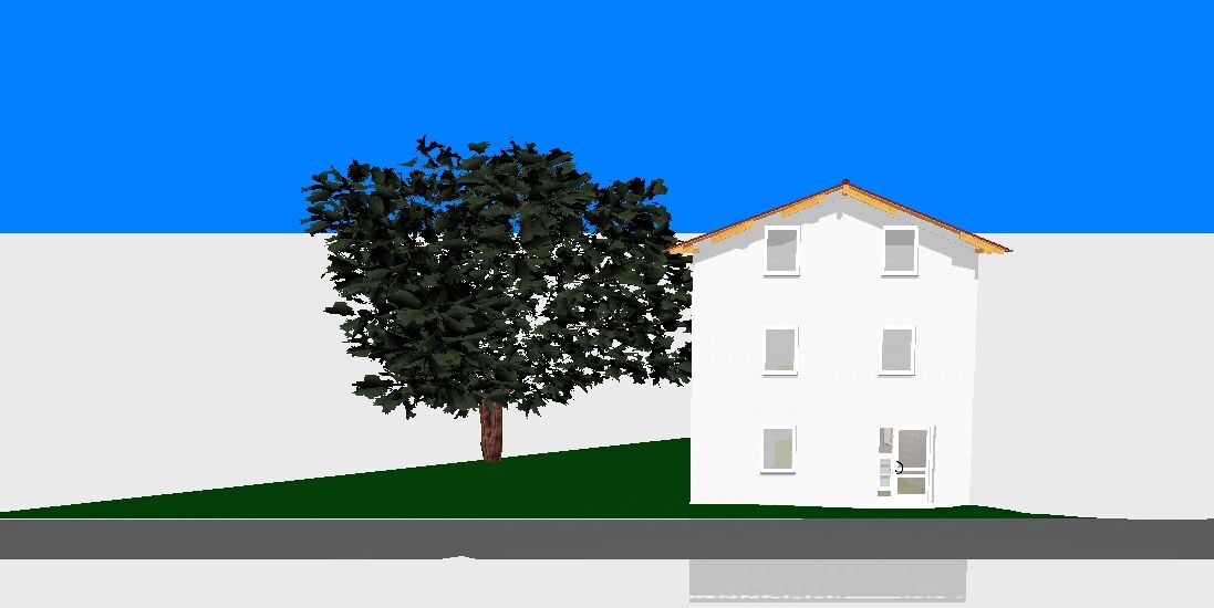

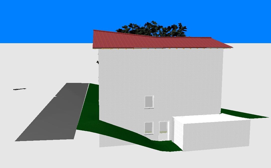

I often like to experiment with these measurements... so I built the "underground garage," added the entrance to the granny flat, and then simply designed a house with slightly angled walls to show what, in my opinion, is the maximum possible space on the plot with the given dimensions.
I don’t see a granny flat as practical here... there’s only enough room for one window.
The driveway will be steep, and actually, the flat section in front of the garage should be longer than the approximately 2 m (6.5 feet) I’ve drawn so far.
Without interior walls, each floor has about 48 square meters (517 square feet) of space. That means the ground floor, first floor, and attic with a knee wall height of currently 160 cm (5 feet 3 inches) and a roof pitch of 22°.
This doesn’t yet take into account that the neighboring property has to support the driveway, which will require additional space.
