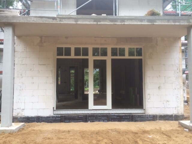

Speaking of windows... some of the windows and/or parts of them have already been installed on the ground floor today. Meranti wood windows!
Two-story house under shell construction with scaffolding, glass fronts, and open construction site.
Unfinished house with large glass doors, white frames, construction scaffold, and soil in front.
Two-story house under shell construction with scaffolding and roof structure.
