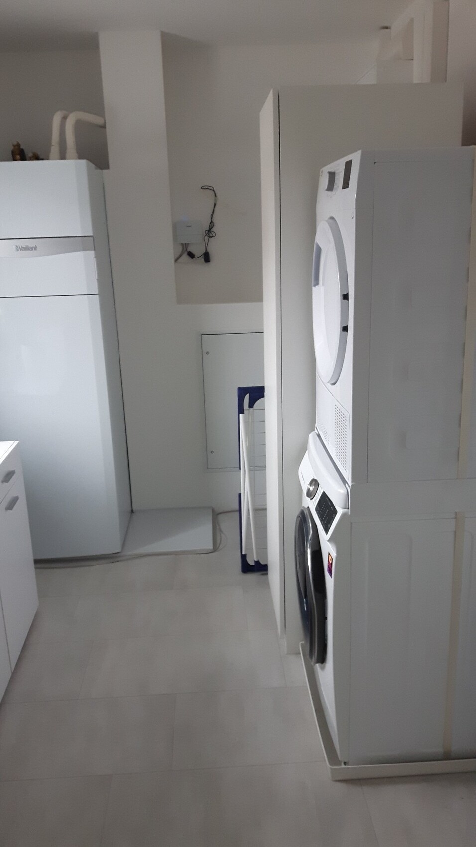

We were able to fit everything neatly into 9.2 m² (99 sq ft). On the left side, not visible in the photo, there is a cabinet 2.20 meters (7 ft 3 in) tall and 1 meter (3 ft 3 in) wide. Next to it is the photovoltaic home power system. Behind the meter cabinet in the back right corner, hidden from view, is the water softening system.
There is even space for the drying rack. So with smart planning, you can fit quite a lot in.

I believe there is some confusion here between what is "desired" and what is "mandatory."
It is not the technicians who simply prefer certain distances, but rather the regulatory requirements that specify them. Architects and contractors must comply with these rules to avoid any issues.
For example, the working area in front of the heating system is regulated, as is the space in front of the main electrical panel, among others.
There are also safety considerations involved, ensuring that a technician has enough clearance in front of the main electrical panel, for instance, in case of an electric shock...
So, it’s not about the spacing between washing machines placed side by side, but about the distances for permanently installed equipment—usually “in front of” rather than “beside” them. That’s why the layouts in products like Ypsi or Borxx work, as they provide sufficient space in front of each device.
