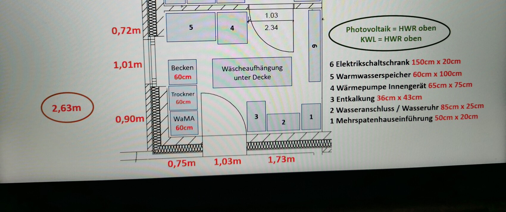

Sure, here is our utility room layout.
For your information: Adjacent to the utility room, we have another space for storage, freezer, etc.
Floor plan with appliances (washing machine, dryer, washer-dryer), sink, laundry drying rack, dimensions.
olop01y26 Jan 2022 09:45
Ypsi aus NI schrieb:
Sure, attached is our utility room plan.
For your information: adjacent to the utility room, we have an additional space for storage / freezer, etc.
You won’t believe it, this is truly a blessing for us! We will take a closer look and try to optimize our plan accordingly. This is a great help, thanks again! 🙂
borxx
1 Feb 2022 00:10
If you haven’t decided yet, here’s a suggestion... You can easily stack the photovoltaic storage and inverter on top of each other. Ventilation distributors save space when mounted on the ceiling.
I boldly moved your front door 20cm (8 inches) to the right.
Technikraum Grundriss: Tür, PV-Leerrohr, PV-Speicher, drei WM-Symbole, Maße.
olop01y1 Feb 2022 08:37
borxx schrieb:
If you’re not set yet, here’s a suggestion... You can easily stack photovoltaic storage and the inverter. Installing the ventilation distribution unit on the ceiling saves space.
I cheekily moved your front door 20cm (8 inches) to the right.
Oh wow, thanks, that looks great!! No, we’re not decided yet, and every idea helps. Thanks for your support 🙂
