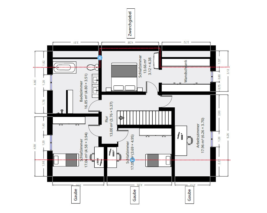

Bruchpilot277 Oct 2020 12:22By the way: we will do some of the work ourselves. We plan to carry out the earthworks and then install doors, windows, flooring, and drywall on our own. We will also do the painting. However, I have not yet included these costs in the budget.
A freelance architect will be designing the project soon. It is still unclear whether we will handle the individual contracts ourselves or work with a general contractor.
Regarding the upper floor, I have attached a new version: ypg, you have a good eye -> the 2m (6.6 ft) line indeed didn’t quite fit in some places. I tried to improve it by adding two “dead spaces.” In all other rooms, it should work with the dormers and gable windows. The bed should fit, as the room is exactly the same size as our current bedroom, apart from a few centimeters, and we really like it. It will be used just for the bed, nightstand, and some clothes.

Did you know that the number of gables is often limited by linear meter on the roofs?
They can be quite costly as well.
Make sure how many gables you are allowed: often max. 1/3 of the roof side.
But it’s also stated here:

brandner186021 Oct 2020 12:41Where do you go down to the basement?
Nice-Nofret24 Oct 2020 17:12I would definitely avoid placing the only toilet in a family bathroom against a bedroom wall; you can hear it.
pagoni202024 Oct 2020 17:29Bruchpilot27 schrieb:
Plans will soon be created by an independent architectThat is a sensible approach... but what does the word "at first" mean in this context? I wonder why you don’t first go there with all your wishes and needs and have this independent (“free”) architect design your floor plan accordingly.
With the sequence you've chosen, I fear the architect will have to put in considerable effort to convince you to deviate from a floor plan that has already been created and possibly optimized in advance.
