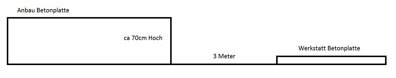

In theory, you can run the supply and return lines from the manifold with two appropriate pipes into the workshop and install a secondary manifold there. The pump assembly should handle this without any problems. The height difference is not critical, especially if the pump assembly is positioned higher.
In my house, I also have 3 manifolds fed by a single pump assembly. Each manifold is connected using 28 mm (1.1 inches) stainless steel pipes. However, I have 28 heating circuits distributed over the 3 manifolds. Depending on the pipe spacing (10 cm (4 inches) in my case), you would get about 6 heating circuits for your situation (assuming the same 10 cm spacing), which means 1 heating circuit per 10 m² (108 ft²).

Here is a drawing made with Paint (side view).
On the left is the extension, on the right the workshop.
The extension measures 7.5 x 5 meters (two rooms) and the workshop 4 x 5 meters (one room).
I also already have a district heating pipe with two pipes, if that’s the correct term.
Would it be possible to feed from the heating circuit distributor, which is installed in the extension including pump with supply and return lines on the right side, into a distributor in the workshop?
I have made a picture for this..
