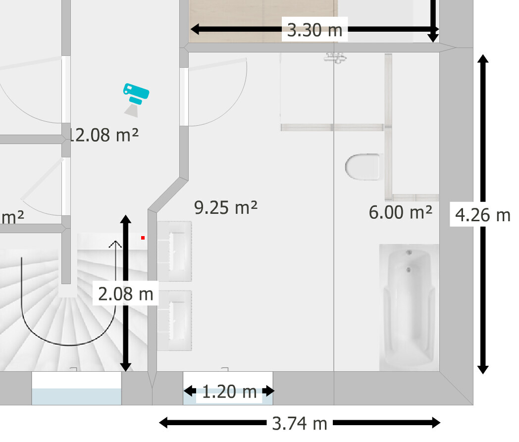

We are currently finalizing the floor plan for our single-family home. One area where we feel it might not be quite optimal yet is the layout of the bathroom on the upper floor. (There is only a small guest bathroom on the ground floor.)
The image shows the current proposal from the general contractor, which we basically find quite appealing, but on the other hand, still not ideal. Maybe you could offer some suggestions.
A few details about the design:
Walk-in shower with tiles on the floor, 1.4 x 1 m (4 ft 7 in x 3 ft 3 in) with a glass door and a masonry side wall.
(Simple) bathtub, 170 x 75 cm (67 in x 30 in)
2 washbasins
1 electric towel warmer (not shown in the plan)
The room is located under the roof with a 1 m (3 ft 3 in) knee wall and a 45° roof pitch (knee wall shown on the right exterior wall in the image).
The window is NOT floor-to-ceiling.
Detaillierter Grundrissplan eines Hauses mit Maßen, Wänden, Türen und Treppen
What we don’t quite like at the moment is that when you enter, you walk directly into the shower. Also, while there is a nice large open space, there are relatively few free walls for placing cabinets or dressers. If we move the shower to the lower side, a lot of natural light from the window would be lost...
None of this is a big problem, but if anyone has ideas for improvement, we would be happy to hear them.

Is the position of the window fixed?
Is the central gray line marking the 2m (6.5 feet) limit, or does it represent something else?

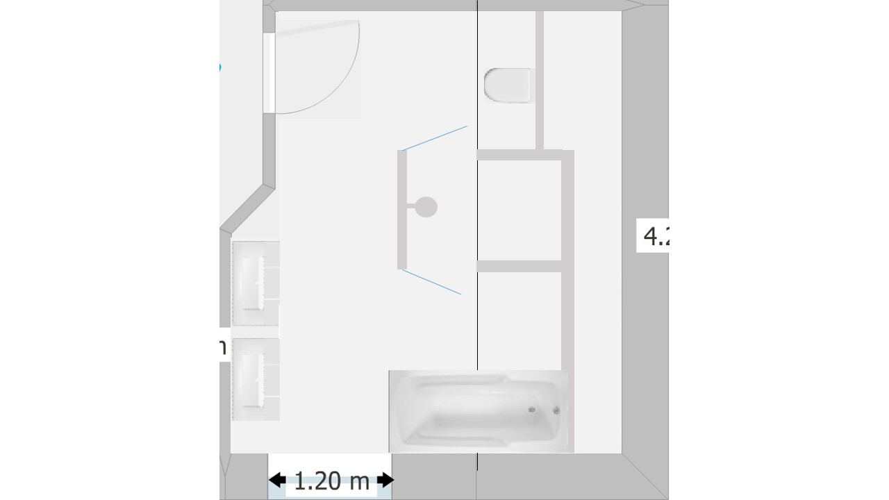

Bathroom floor plan: double sink on the left, toilet at the top, bathtub at the lower right.

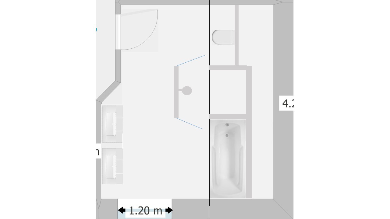

Bathroom floor plan: bathtub at the bottom, two sinks on the left, toilet at the upper right.

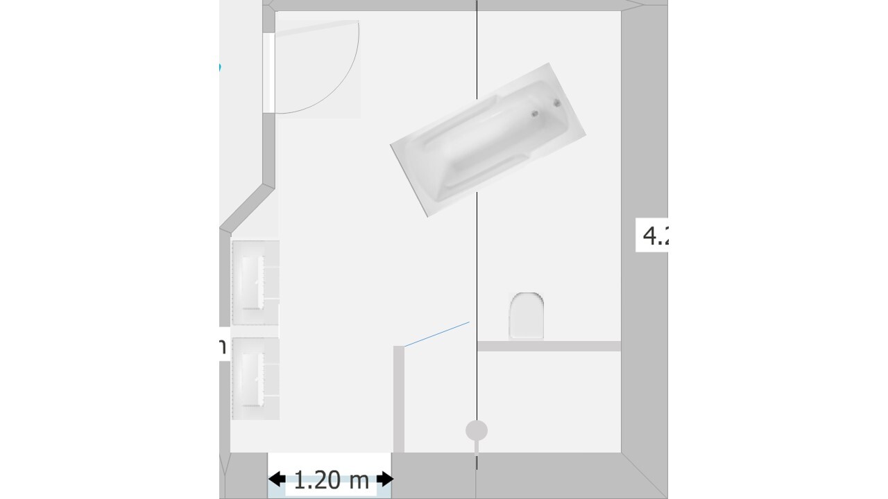

The bathroom would definitely be ideal for a freestanding bathtub to create a wow effect when you enter. Above it, a beautiful double casement window, and just like that, you have your dream bathroom!
Grundriss eines Badezimmers: schräg stehende Badewanne, Toilette rechts, zwei Waschtische links.
Is that gray central line the 2m (6.6 feet) limit, or what is it?
The window is currently located there for symmetry with the window in the stairwell. There is some flexibility, but not much.
The thin line is actually the 2.5m (8.2 feet) line already (approximately, the floor plan was only traced and not from the main contractor).
Alessandro schrieb:
The bathroom would of course be perfect for a freestanding bathtub as a wow factor when you enter.
Above that a beautiful double casement window and the dream bathroom is complete!
That’s definitely a very nice idea, but the bathtub will play a rather minor role for us. I’m also not yet fully comfortable with the shower under the sloped ceiling since I’m quite tall. But overall, I really like the space that’s being created... hmm.
