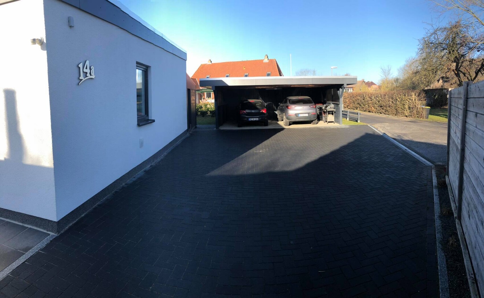

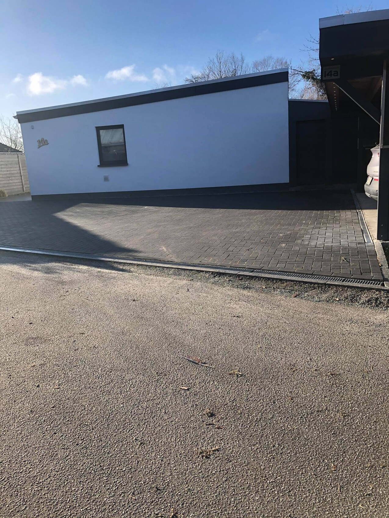

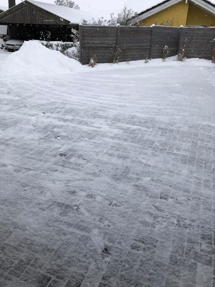

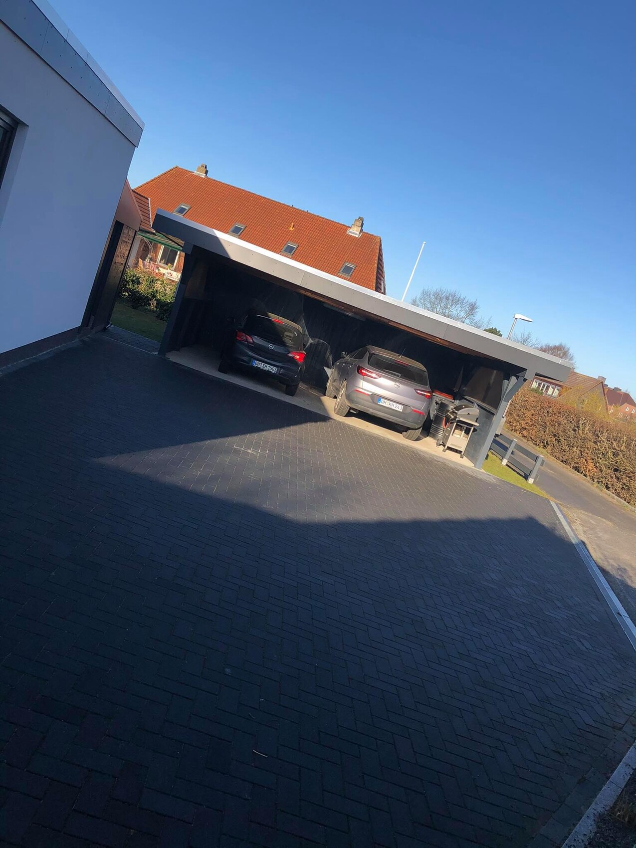

We have almost the same problem.
The house is also higher than the street.
The driveway is about 90sqm (970 sq ft).
The slope from the house wall to the street is good, so water never stands there 😉
Only the snowplow always pushes everything nicely to the end of the dead-end street, where the driveway is located....... see pictures.

@ Caspar, yes, the issue with the snow plow is familiar, and fortunately, it might still be early enough for us to avoid the problem before it becomes an annoyance in the coming years.
How big is your carport? 8m x 6m (26 ft x 20 ft)?

caspar.1
28 Feb 2021 10:00
lesmue79 schrieb:
@ Caspar yes, the issue with the snowplow is familiar, and hopefully we are still early enough with this topic to avoid problems in the coming years.
How large is your carport? 8m x 6m (26ft x 20ft)?
7m x 7m (23ft x 23ft) concrete slab, and the roof is 8m x 8m (26ft x 26ft). I wanted 50cm (20 inches) roof overhang on each side 😉
