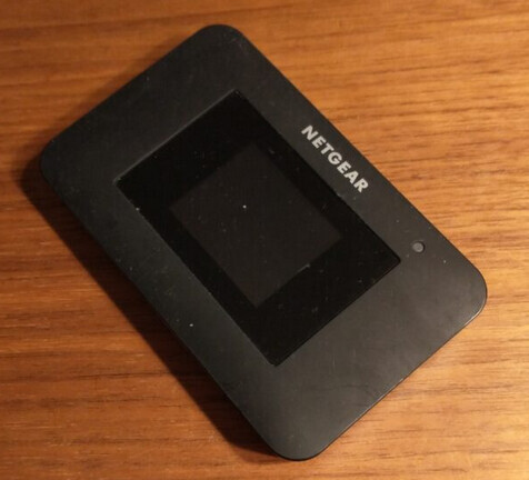

WilderSueden2 Jun 2023 09:48WilderSueden schrieb:
We already had a battery-powered device for other reasons. You just insert a SIM card, and it creates a Wi-Fi network. All devices then connect to the Wi-Fi as usual.
Cool. I guess that thing can also stay connected to the main power supply continuously, right?Similar topics
