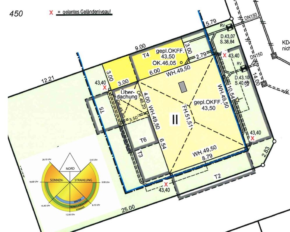

I’m curious if anyone here is really knowledgeable about photovoltaic systems or if anyone knows of a website where you can calculate the performance and orientation.
We have a townhouse measuring 12 x 9 meters (39 x 30 feet) with 60 cm (24 inches) roof overhangs and a 25° pitch. The house offer stated that we would get a 9.9 kW photovoltaic system. However, we were already told that the roof area is not sufficient and that some panels would have to be placed on the extension. We actually don’t want that; we want everything on the hipped roof. According to the technical company, only 9.5 kW would fit there with an east/west orientation.
Since our house’s main roof surfaces are oriented roughly northeast/southwest, I’m a bit concerned whether it makes sense to install half the system on the northeast side. According to a table I found, that would be an azimuth of -110° and only yield about 79% efficiency. Now I’m wondering which would make more sense: the technical company’s suggested layout or utilizing the smaller roof surface nearby, which faces southeast. Of course, fewer panels would fit there, so the system would probably be closer to 7 kW, but could it generate more energy this way? We would also save money because fewer panels are needed. The technical company probably just wants to install whatever they quoted, whether it makes sense or not, as long as they make the sale.
Therefore, I would like to calculate what can be achieved with fewer solar panels but better orientation, compared to more panels with a less optimal orientation.

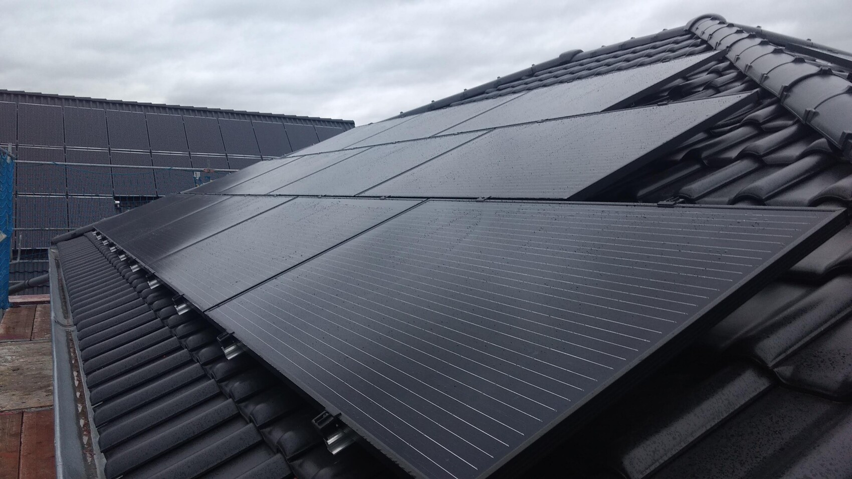

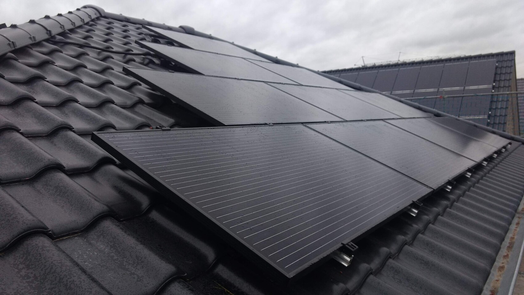

Stadtvilla1917 Mar 2020 12:44Looks good, no idea why they only want to do 2 sides for us, probably because it’s less work and saves costs to climb on just 2 roof surfaces.

Stadtvilla1921 Mar 2020 07:49So, we have now clearly been informed that three sides are not possible because the inverter only has two inputs.
Stadtvilla1921 Mar 2020 10:21No, I didn’t explicitly ask for that. I only asked whether it might make more sense to use the smaller area instead of the larger one. Then they said they wanted to check the possibility of using the smaller area as well. Two days later, they said it’s not possible to use three roof surfaces because the inverter only has two inputs.
