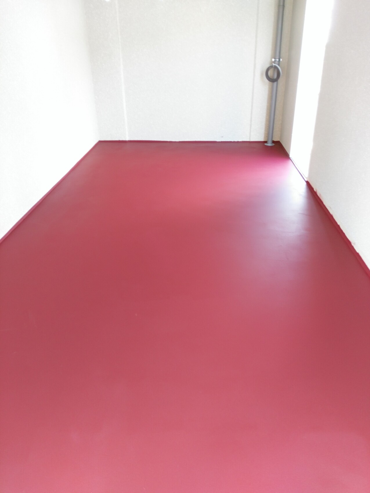

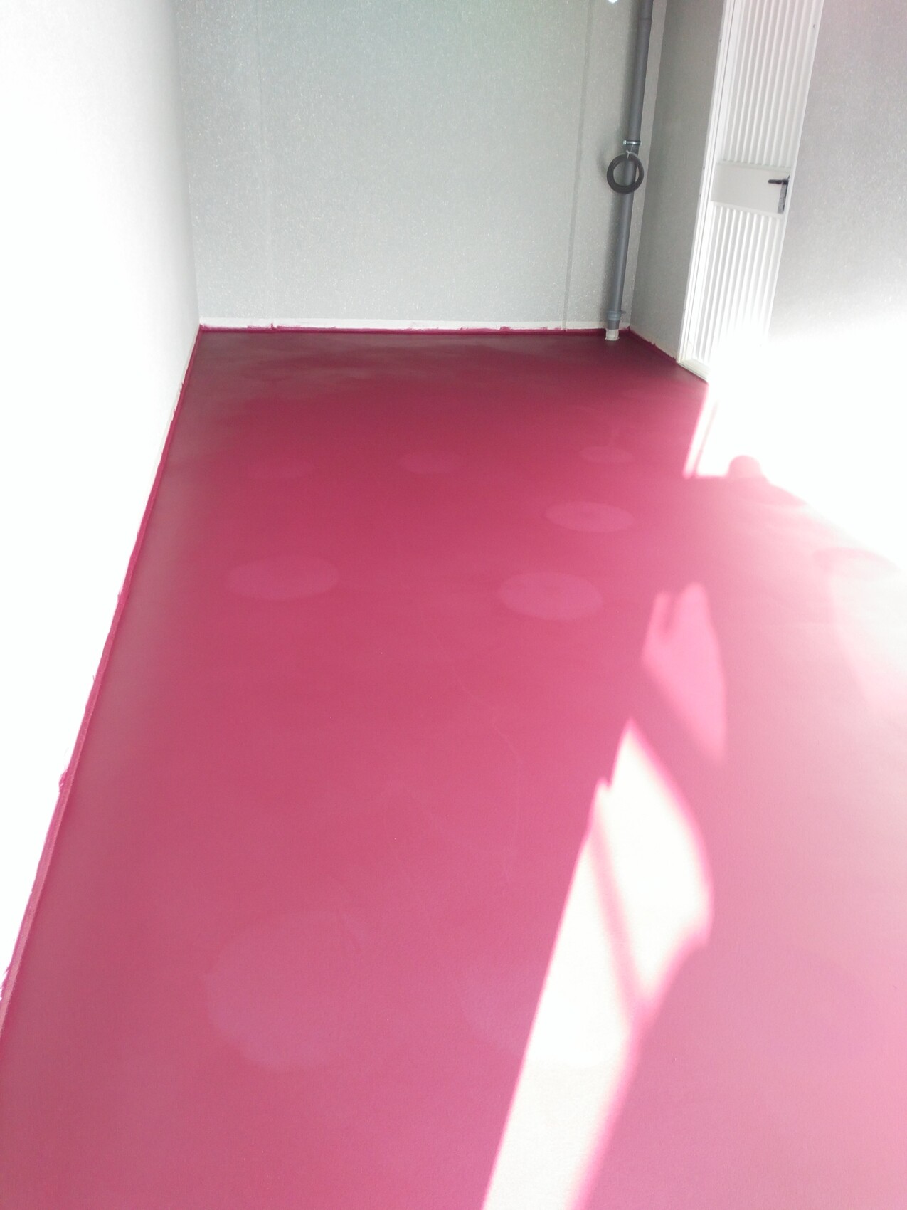

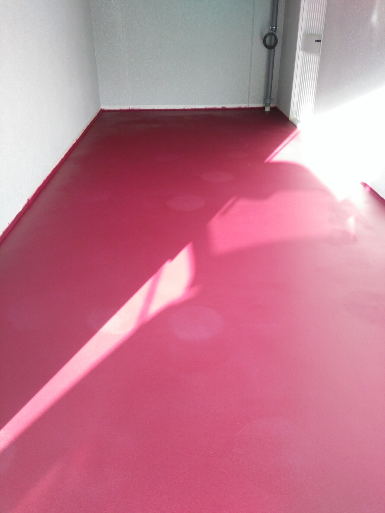

Sackkarre6 Sep 2016 13:24The painting is now complete.
The first two pictures show the first coat of paint after drying for one day. As you can see, there are still some paint spots visible. Apparently, that was not the best method. Perhaps they would have disappeared after the paint fully cured. But, as mentioned, the ambient temperature was not ideal. For the final coat, I poured the paint directly from the bucket, painted one section, and then poured more paint. Since the ambient temperature was lower than the previous days, this apparently wasn’t a problem.
The last two pictures show the second coat of paint after drying for one day. I am quite satisfied with the result. You can still see some roller marks and directions. Maybe these will fade once the paint is fully cured. But since it’s only the garage floor, it’s not a big issue.
