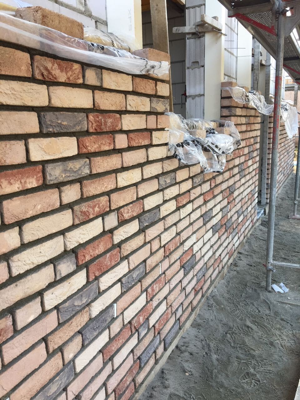

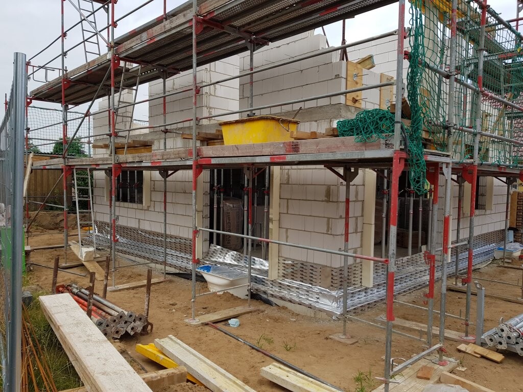

We have now decided on window sills made of brick slips. Neither of us liked the aluminum window sills.
@11ant

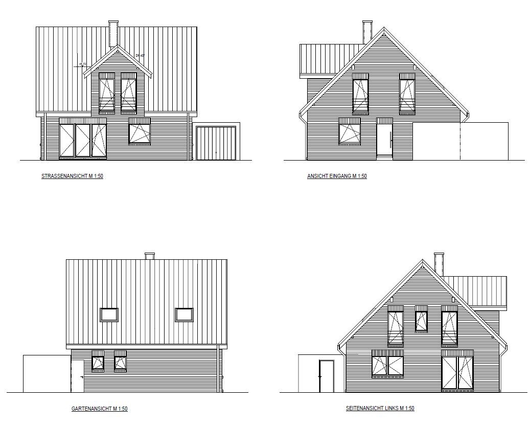

Here are the pictures.
The labels on the views are a bit incorrect. Where it says “garden view” is actually the back of the house, with a 3-meter (10-foot) distance to the neighboring property. The street side corresponds to the garden side, with 12 meters (39 feet) to the street.

Could you tell me how your complete wall assembly is structured and whether you have an air gap in front of the insulation?
Malz1902
6 Jul 2017 12:04
17.5cm (7 inches) sand-lime brick + 17cm (7 inches) glass wool insulation + 12.5cm (5 inches) cladding
I don’t mean an air gap in front of the insulation, but I’m not 100% sure right now. I’ll check this evening and then let you know.

@Knallkörper 1cm (0.4 inches) air gap between insulation and cladding
