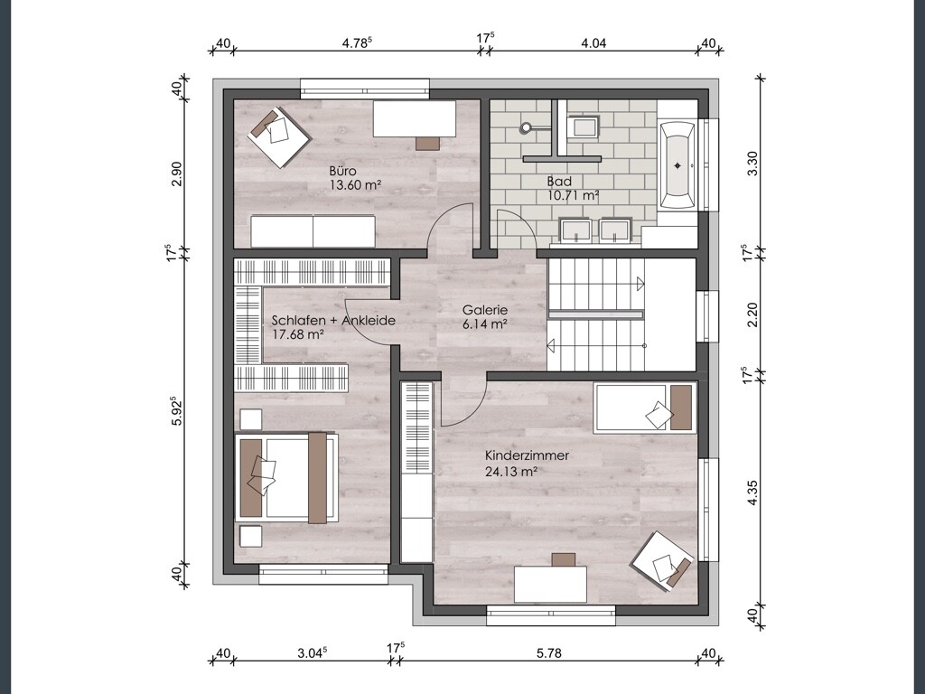

We, a small family (2 adults, 1 child), are currently planning our new house with the developer. They have provided us with some floor plan proposals, which we actually quite like.
We want a spacious living and dining area with an open kitchen, a large entrance hall, a spacious child’s bedroom, and plenty of natural light.
We look forward to your feedback.
Grundriss eines Einfamilienhauses mit offener Küche, Wohnzimmer, Diele und Terrasse.
2D-Grundriss eines Hauses mit Büro, Bad, Schlafzimmer und Kinderzimmer

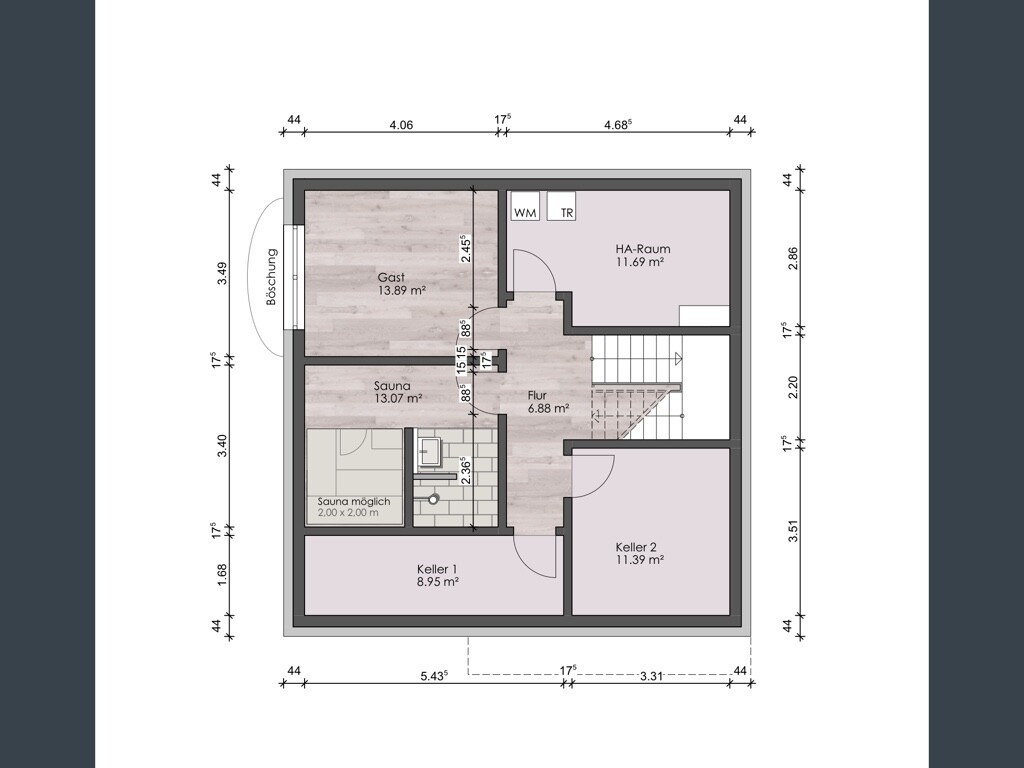

2D-Grundriss eines Hauses mit Kellern, Sauna, Gastzimmer und Flur

I think the floor plan is very well designed for a family of three.
In the basement, I would place the access to the toilet from the hallway so that guests can use it without having to go upstairs. Otherwise, I would say it’s perfect!

Doc.Schnaggls schrieb:
@Manu1976 : Which toilet in the basement are you referring to? I only see a shower and a washbasin there.
Regards,
Dirk
That's correct. You’re right. I was a bit sleepy this morning :-) Well, then I would add a toilet as well.
Manu1976
16 Dec 2014 08:58
Oh, about the lifting station. Nowadays, there are already ready-made toilets available with an integrated system, meaning both a macerator and lifting station combined. I would definitely go for that. Unfortunately, we didn’t do it in our house—for the same reason you didn’t—and now I really regret it.

Manu1976 schrieb:
Oh, about the sewage lifting system. Nowadays, there are already ready-made toilets that have this integrated, meaning a macerator plus a lifting system. I would do it. Unfortunately, we didn’t include it – for the same reason as you – and now I really regret it.
Thanks for the advice. I will check it out and will probably decide to have a toilet installed after all.
