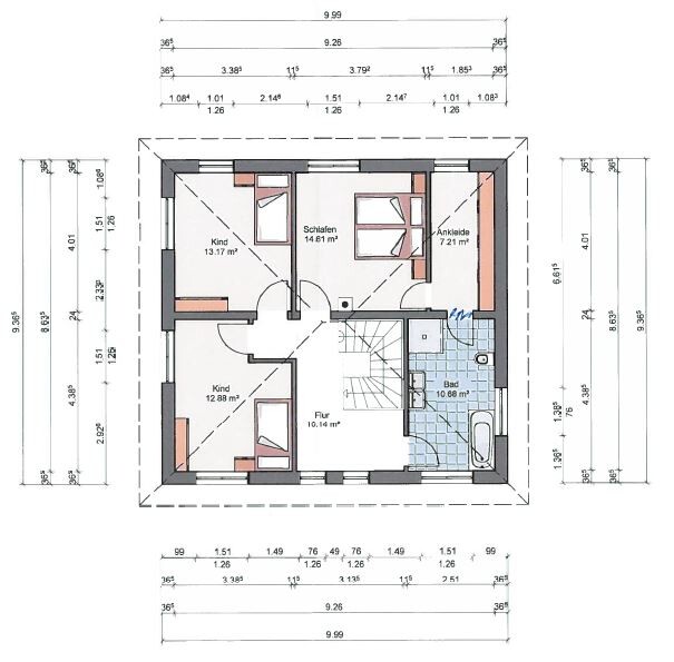

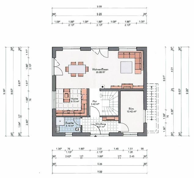

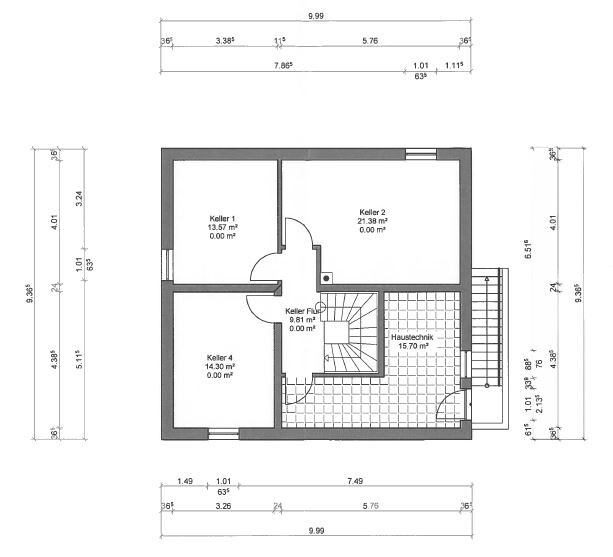

Basti150327 Nov 2014 09:22Hello,
I have attached some exterior photos as well as floor plans of our initial offer. However, we do not want the access from the dressing room to the bathroom on the upper floor. There might still be a few changes, but this is currently our starting point. Any tips are welcome and will definitely be helpful here and there.
