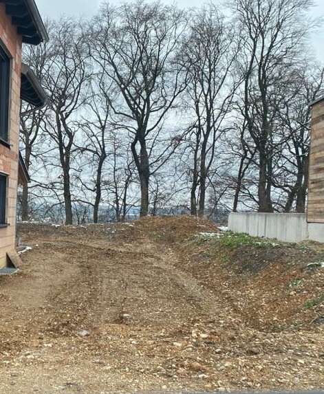

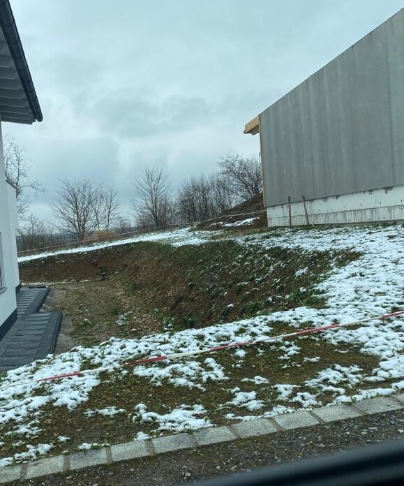

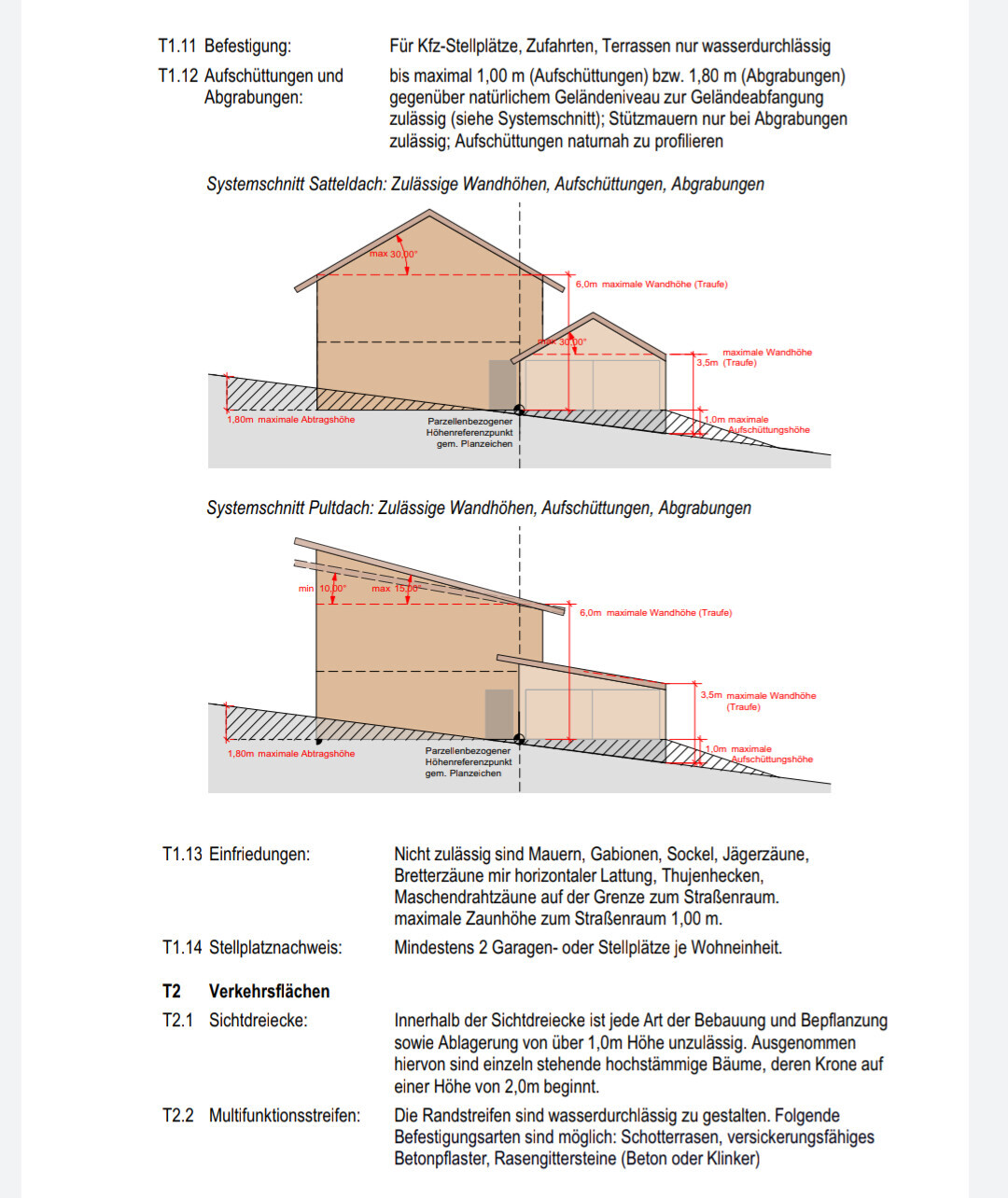

You can pretty much forget about the contour lines by now, since the access road has changed the whole situation.
I’m seeing about 1.5–2 meters (5–6.5 feet) of difference within the building area, so you’ll probably need a basement (which makes sense). What does the development plan say about fill, or does it say nothing on that?
In the aerial image, plots 31 to 33, 35, and 36 are built on and do not show significant terrain modification, although the contour lines clearly indicate slopes towards the basements:
@ ask for a friend
Fill deposits are allowed - up to 1m (3.3 feet) as I understand it. A few construction companies mentioned that they can plan well with this (attached are screenshots from the zoning plan).
@ 11ant
Unfortunately, I didn’t understand... did you mean that the photos show no basements even though maybe all of them required one because of the slope?
I also took some photos as suggested... do they help to estimate what others have done? (I deliberately cropped the houses)...
@ 11ant
chyogoo schrieb:
I also took a few photos as suggested... do they help to assess what the others have done?You can definitely show the houses fully (see "Friesenhaus decision"). Yes, from your pictures—unfortunately not from the aerial view—you can see that some terrain modifications have been made. The site-specific elevation reference point is marked on your property at the transition between the street and the parking spaces, but unfortunately the exact measurement is not indicated.https://www.instagram.com/11antgmxde/
