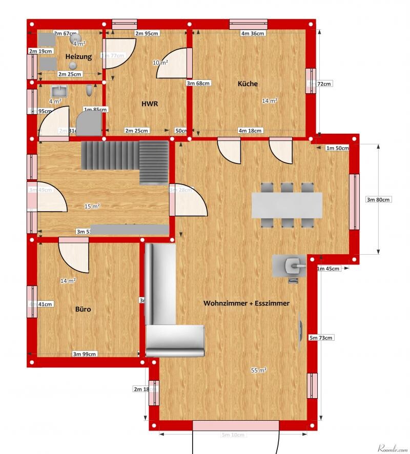

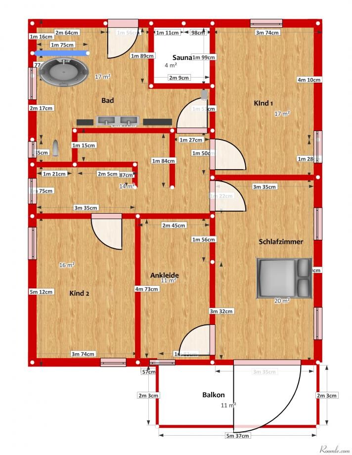

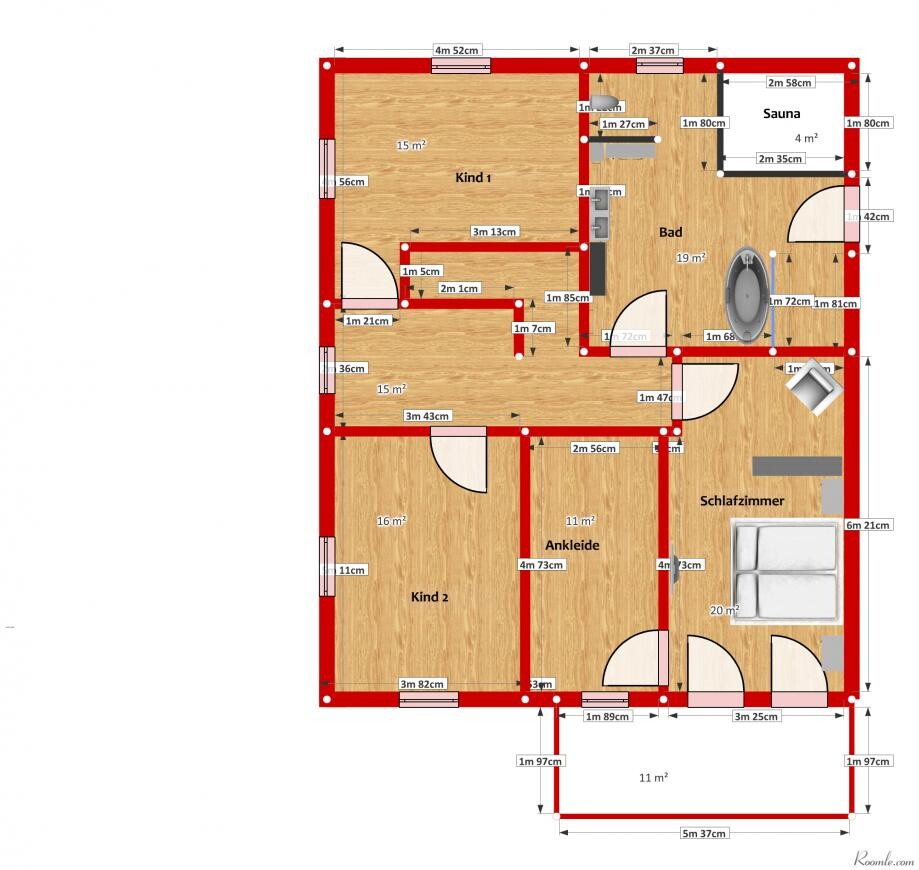

Hello everyone, here is my second topic. I have already planned a floor plan that is practical, but it still needs some fine-tuning in terms of aesthetics.
Now my questions for you.
Where could improvements be made?
Attached are 2 versions of the upper floor (bathrooms swapped). I’m not entirely sure where to place the bathroom. Maybe you have some ideas and suggestions for improvement.
Thank you

Hello and thank you very much.
Of course, the floor plan will be reviewed by an architect again. It’s just about having something on paper to start with.
I don’t understand how you arrive at half a million. Even if I estimate €1600 per square meter, I come to about €320,000.
The house will be built with solid construction, including a significant amount of self-performed work plus the land is already owned.
Question: why do you think there might be issues with the structural engineering? Exterior walls are 36.5 cm (14.4 inches) brick, load-bearing interior walls 24.5 cm (9.6 inches).

Let me put it this way: a floor plan drawn by an amateur makes the architect’s job much more difficult.
Make a list of the things that are important to you, and let the architect create the drawings... that’s their job. And if they are good, the final floor plan will be much better by far.
A floor plan like this needs to be developed together. Trying to do it beforehand only limits your view of good ideas.

Regarding the structural engineering:
As I said, I’m not an expert and can only guess.
I’ve heard that floor components can span about 7 meters (23 feet). If you need longer spans, load-bearing walls are necessary.
Your living room is very large, so I assume that the ceilings will be supported on the left and right sides, with a load-bearing wall in the middle. However, this load-bearing wall between living room/office, living room/hallway, and kitchen/utility room is not continuous.
It also makes sense to design the lower bay window so that there is no corner formed at the office/living room wall.
This is better solved in the upper floor plan where the continuous wall between children’s room 1 and bedroom is shown. However, that wall would not be located above the load-bearing wall on the ground floor.
I don’t know why you need so much space, but based on your furniture layout, the bedroom and living room seem somewhat oversized.
That could even feel empty in some circumstances.

Musketier schrieb:
Regarding structural engineering:
As I said, I am not a professional and can only guess.
I heard that ceiling panels can span around 7 meters (23 feet). If you need more, you require load-bearing walls.
Your living room is very large, so I assume the ceilings on the left and right sides are supported, and a load-bearing wall is needed in the center. However, this load-bearing wall between the living room/office, living room/hallway, and kitchen/utility room is not continuous. “Saying ‘I heard’ doesn’t help the original poster. Either you have knowledge and expertise on the specific topic, or you say nothing. 🙄”
In my house, I have spanned 9.24 meters (30 feet) with ceiling panels WITHOUT support walls, columns, or anything else.
