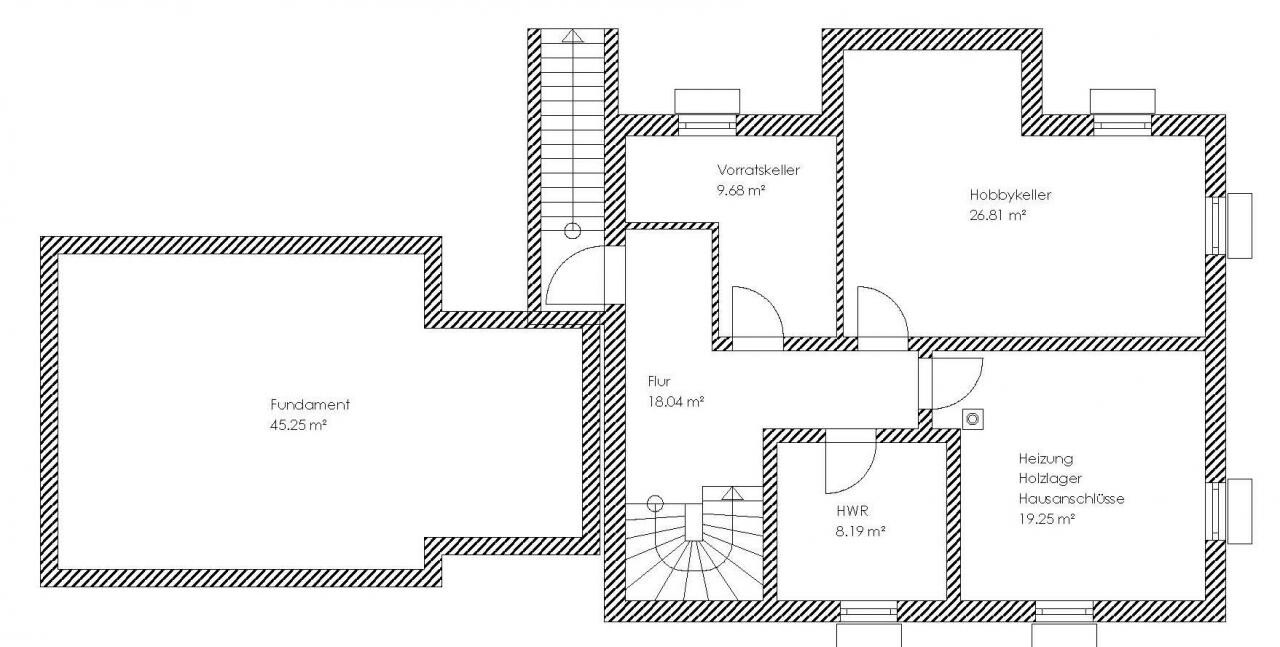

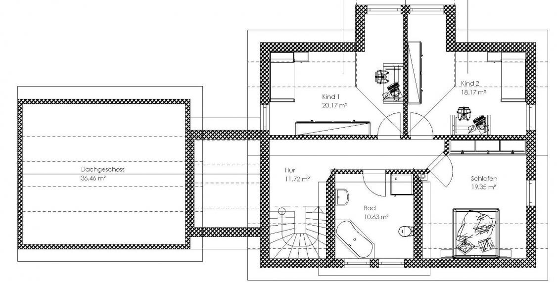

attached is our house design. Apart from the layout of the attic floor, everything is basically finalized. Maybe someone will notice something else.
Improvements and opinions are welcome 🙂
Floor plan of a house with garage, open kitchen, dining area, and living room.
Attic floor plan with rooms, hallway, and bathroom
Basement floor plan with foundation, storage cellar, hobby cellar, hallway, heating, and utility room

I think the floor plan itself is very nice. Everyone has their own individual preferences.
Personally, I don’t find an entrance hall very appealing visually; it can seem a bit outdated. I also don’t really like having two doors in the kitchen from an aesthetic point of view, especially when you’re standing in the kitchen. I would prefer to enlarge the opening from the living room to the kitchen and remove the other door.
