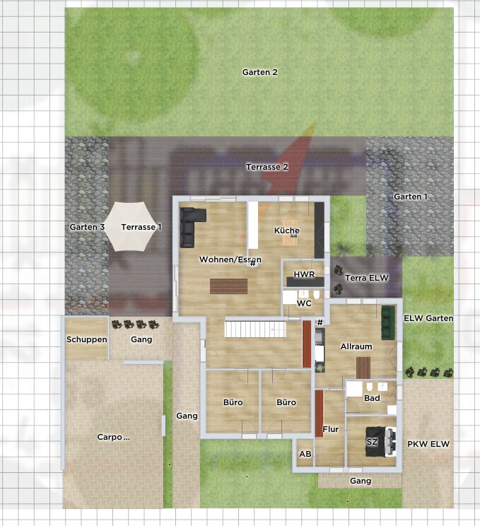

First of all, I find one thing really cool:You should see the one with the walls, that one is even cooler 😉 Let’s see if I can fix it. I must have messed up somewhere because all the walls are invisible or deleted. gregman22 schrieb:
2) It can definitely happen that I organize a guys’ gathering and we want to use the sauna in summer. Then everything takes place in our master bathroom...Ahem: something like that should of course be on the list of needs and habits. It’s personal and should work well in everyday life. gregman22 schrieb:
So the two separate (preferably small) offices are essential. We also want to include the first guest room somewhere, which could later be converted into a child’s room, plus one fixed child’s room. This way we save one room.It wasn’t really clear that you’re flexible with one or two rooms. To me, it sounds rigid and fixed regarding the room requirements—and apparently I’m not the only one who feels that way.The challenge is to achieve a harmonious roof design. My software can’t do that at all, so we’re lacking the eye to judge if it fits well.
Here’s the explanation: Two offices on the ground floor with a shower toilet ensure that during illness or when hosting guests, there is convenient accommodation on the ground floor. The staircase is rotated so you can get your bicycles out through the front door.
Kitchen: I don’t think you are the open island kitchen type, so this is just a rough idea.
Air space with a balcony to protect the southwest side. Garden to the north, but also southwest.
Children’s rooms on the upper floor have a separating hallway to reduce noise from the air space.
The master bedroom side could be more flexible and creative.
By the way, the upper floor has an overhang on the front southwest side to shield the entrance from rain (and to give the children’s rooms a decent size... but it could be adjusted more flexibly).
Unfortunately, due to this, the house is oversized. Overhangs of 50cm (20 inches) or more are counted towards the floor area 😕
