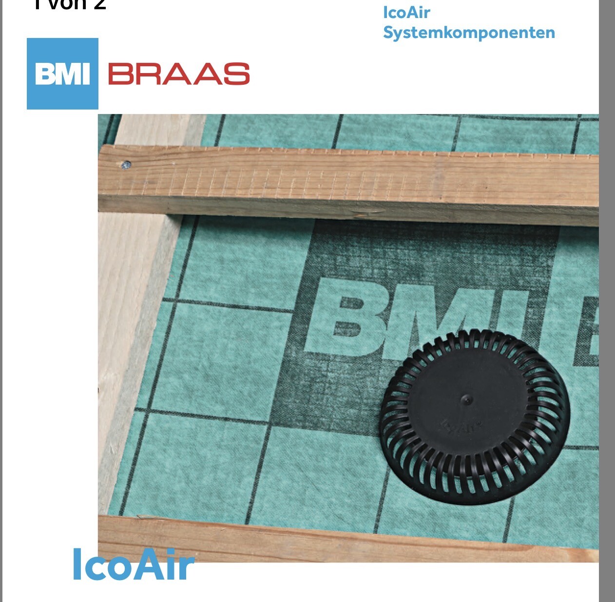

So, we have now replaced the old membrane with a new breathable membrane. The insulation has been reinstalled dry.
One question still needs to be answered for now 😉
Does the roof underlay really need to be open by about 5cm (2 inches) at the ridge? Is a non-sealed overlap at the ridge sufficient? Does this opening need to be present at every rafter space?
