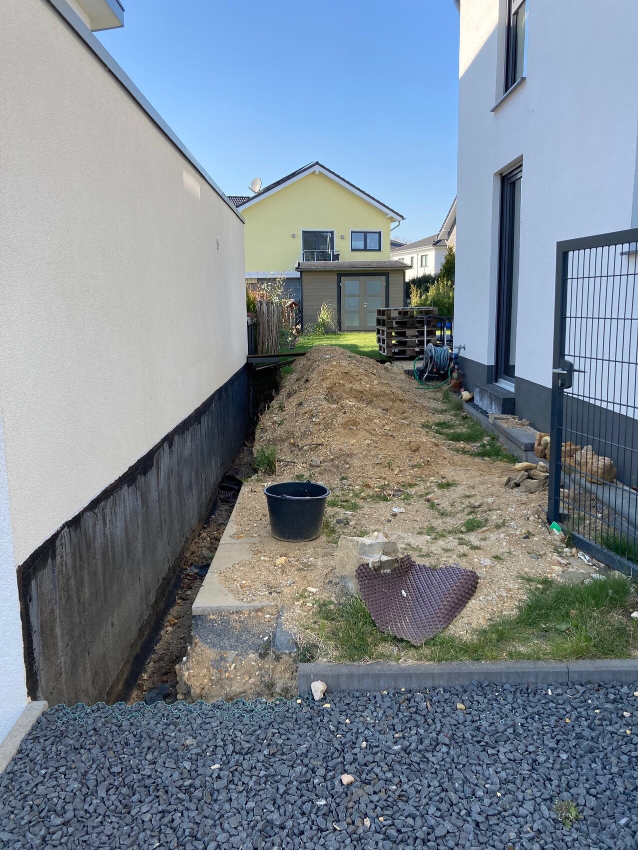

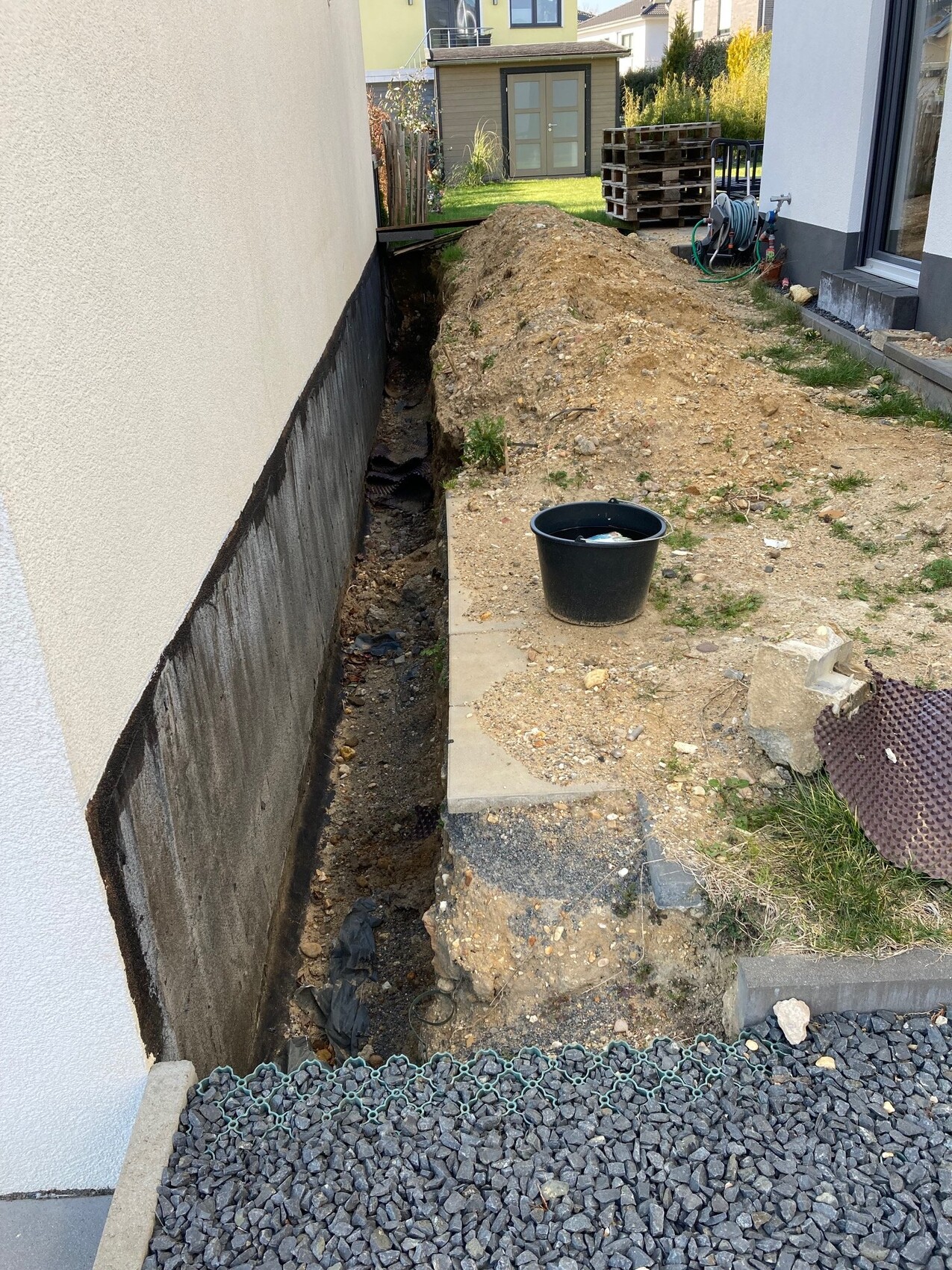

we have the following situation: there is a difference in ground level between our neighbors’ property and ours. As a result, soil was piled up by our garden landscaper against their garage. He only used a dimpled membrane as protection for the garage wall. After about 4 years, the entire length of the garage showed moisture damage inside the neighbor’s garage at approximately 5 cm (2 inches) above floor level. Until then, apparently only the garage base had some form of damp proofing. The landscaper does not consider himself responsible, arguing that the neighbors should have waterproofed the garage higher since they should have known the neighbor’s property was at a higher level, but that is not the point here. We have now excavated a trench and applied a bitumen coating to the garage façade and installed a cove fillet at the bottom.
Now we would like to refill the soil and have some questions: 1. Is a renewed dimpled membrane sufficient in combination with the bitumen layer and cove fillet? 2. If yes, which way should the dimples face? It seems there are benefits in both directions. My instinct is to have the dimples facing the garage so that the wall can be ventilated behind it. 3. Would using a dimpled membrane with a geotextile fleece provide additional protection?
I would really appreciate some advice.

I will upload photos tomorrow.
