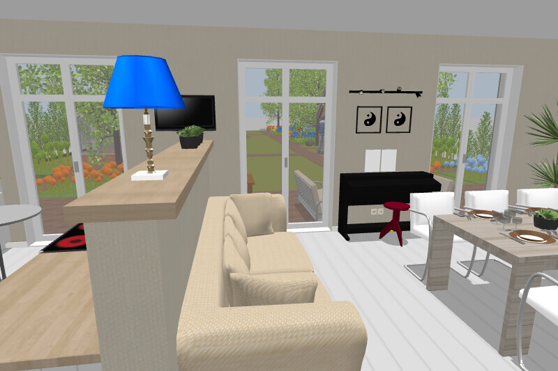

Hello Uwe, okay... Double-leaf patio doors with a width of 125 cm (50 inches) could still fit in our place as well...
Could you measure the width of the opening on your 1.25 m (4 ft 1 in) window when one sash is open? Thanks.
Best regards, Steffi
Here’s another photo from the inside.
I’ve now widened the patio doors to 125 cm (50 inches):
Bright living room with beige sofa, kitchen island, blue lampshade, dining area and garden view

Are 47cm (19 inches) wide enough for a quick exit? It seems quite narrow to me. What do you think? Best regards, Steffi.
Way too narrow – and having to open both leaves every time is quite impractical. You’ll only regret that later...

Hello Sebastian, I feared that. If I widen the patio doors to 125cm (49 inches), I end up with about 53cm (21 inches) clear opening width for one panel (that’s my calculated estimate... I don’t have such a door in front of me... maybe Uwe can give me an exact value on Sunday). Is that still practical enough? Best regards, Steffi
Sebastian79
10 Nov 2015 11:01
I would still say no – to be able to get out somewhat comfortably, I would choose a 73cm (29 inches) door.
But since it’s a terrace, you often have a tray or something similar in your hand, so the door should be at least 83cm (33 inches) wide – preferably a bit wider.
Honestly, I would let practicality decide here rather than the appearance.

10 Nov 2015 11:15
Yes.. I think you’re right. I will probably go with muntins for the look but stick to the single-leaf 112cm (44 inches) patio doors. Same for the windows. Thanks for all the input. Best regards, Steffi33
