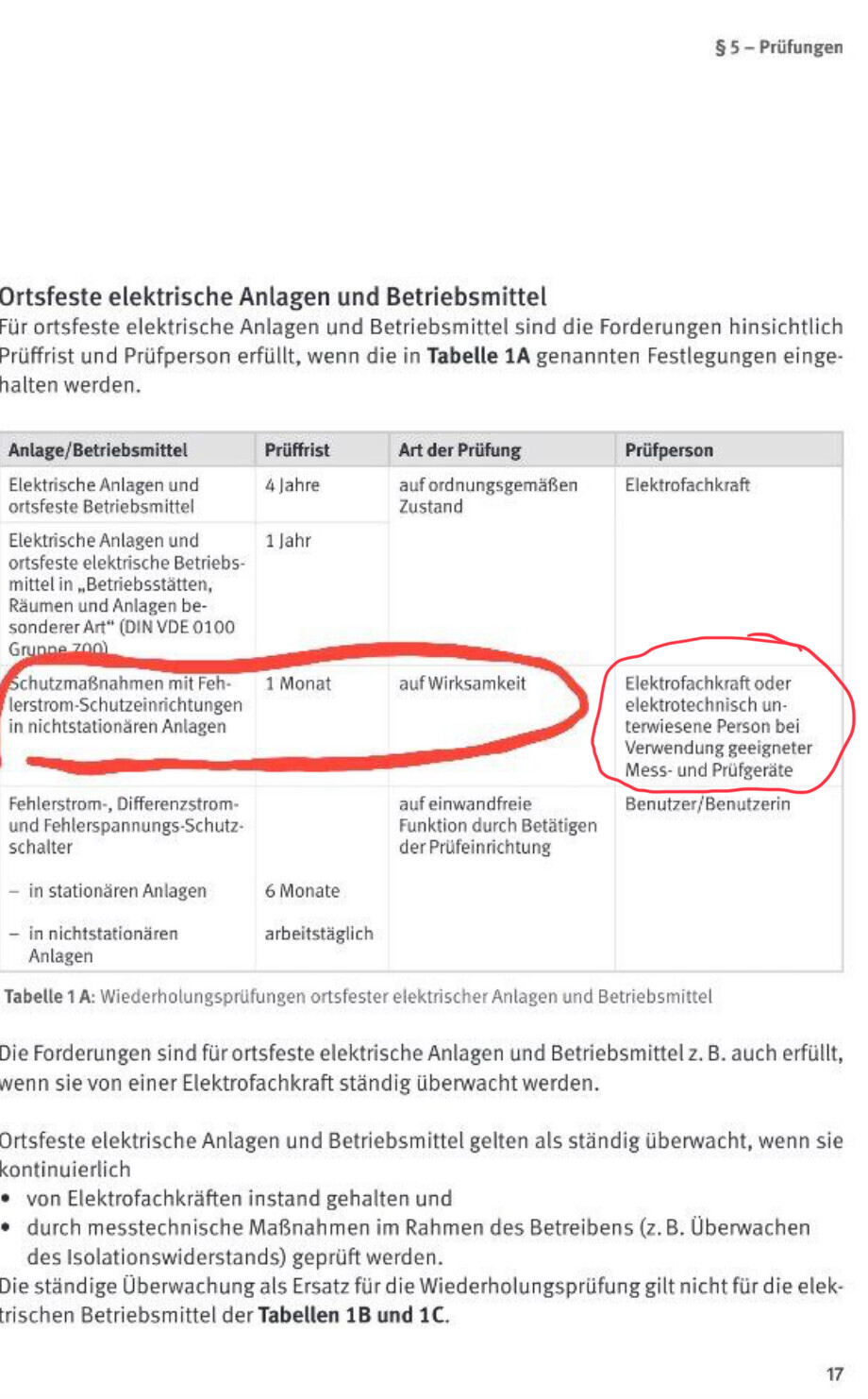

Gregor_K
7 Oct 2023 12:23
The monthly inspection can also be carried out by a person with basic electrical training. See also the screenshot. However, for companies, this inspection is actually mandatory.
Excerpt from regulations: table on inspections of fixed electrical installations and RCD protection.

xMisterDx
7 Oct 2023 12:54
Yes. But the EuP also has to drive there, press the button, document it, and then drive back. It doesn’t cost 140 EUR, but you have to allow about an hour, so it adds up to around 60 to 70 EUR.
