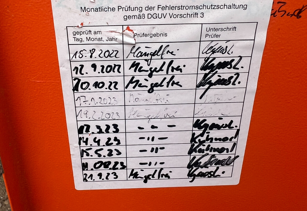

I visited the construction site again and inspected the temporary power distribution box. I could not find a TÜV sticker. There is a DGUV Regulation 3, but this applies to companies and publicly owned enterprises.
Sticker with table for monthly testing of the residual current device (DGUV Regulation 3)
