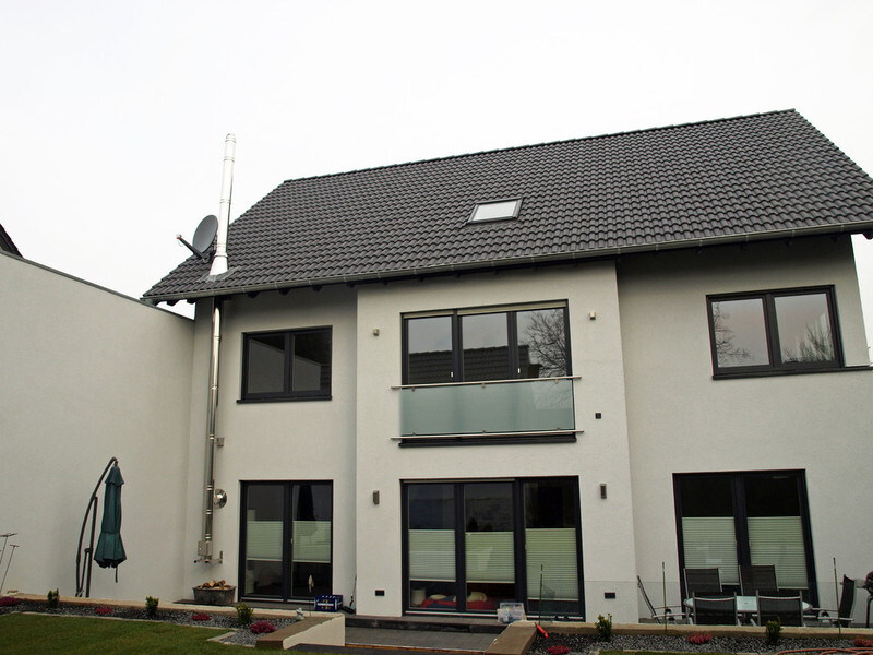

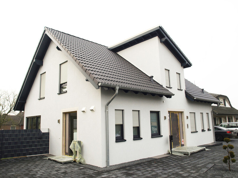

Bauexperte24 Mar 2015 16:17Hello Micha,
It will probably look similar to our project attached here. On the ground floor there is a separate granny flat, the basement contains the living area, and the attic has the bedrooms. This rather uncommon room layout was requested by the family. The height difference between the ground floor entrance and the basement is a significant 3.00 m (10 feet).
Best regards, Bauexperte

Wow, that’s really unusual; it definitely wouldn’t be my choice. But maybe the architect still has some interesting ideas.
However, you just get obstacles placed in your way. If the garage could be positioned significantly further back, the entrance situation in the basement would work, but since it has to end at 12 meters (39 feet), it somehow feels unsatisfactory.
