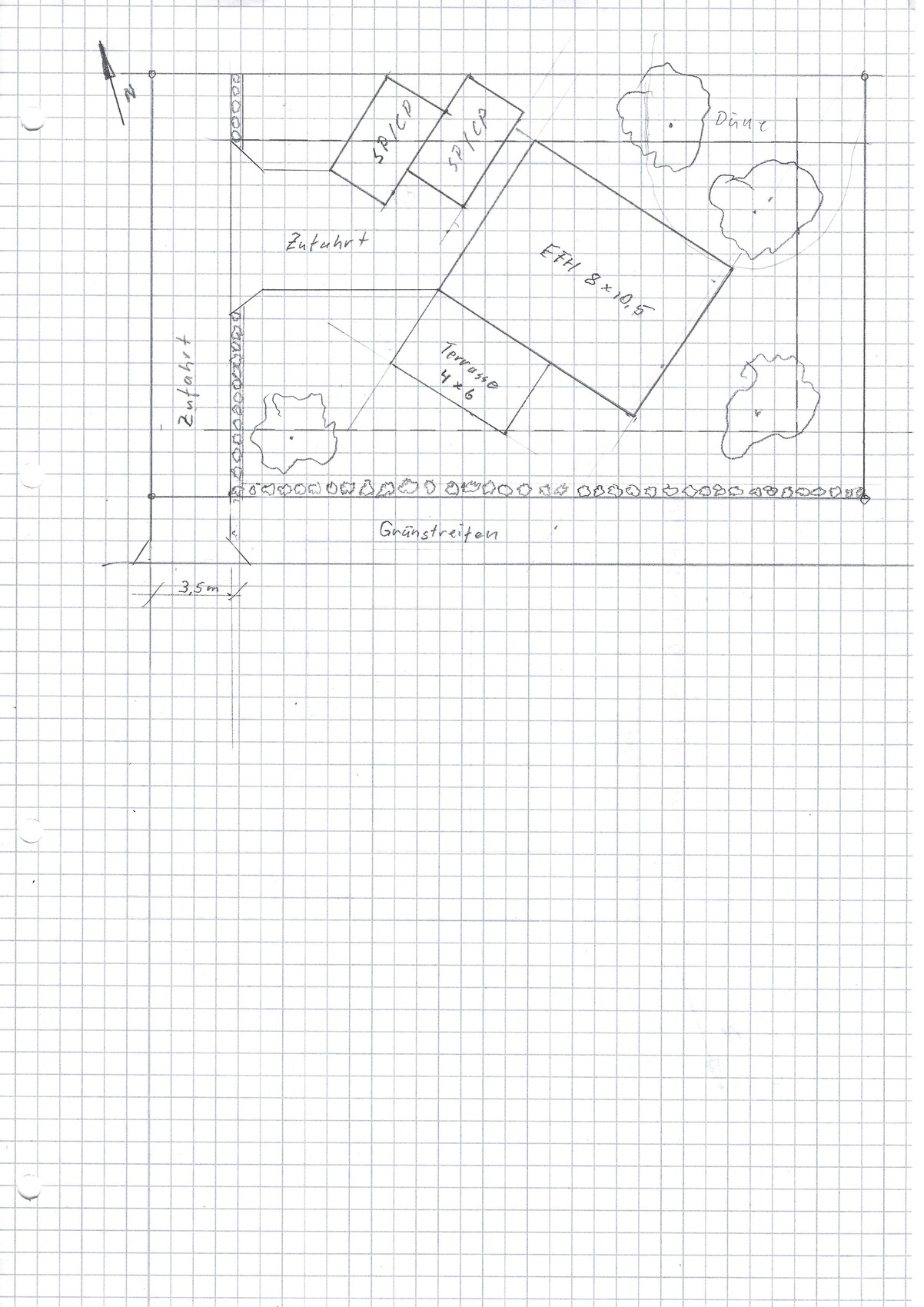

I have roughly drafted a layout plan by hand:
We have already marked the house on it. However, we are unsure:
1. Does the house make sense in this position?
2. Should we choose a rectangular footprint instead of a townhouse style?
What are your thoughts?
Thank you very much for your advice!
Matthias

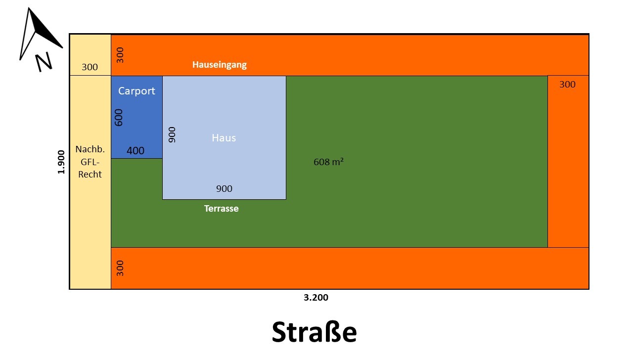

icandoit schrieb:
@ypg
Do you mean something like this?
[ATTACH alt="Grundstück 5.jpg"]58070[/ATTACH]I like that 🙂I’m not one to complain about creativity, considering how some people misuse certain software here.
But when you put red stripes around a green area, the brain interprets that zone as a danger area, or at least people tend to mentally exclude that space. That distorts the mental image.
I actually think the design isn’t bad at all... better than all the others. Would it be an option to shorten the driveway a bit? Or did you stretch it on purpose to place the garden area on the west side?
I like that 🙂
Thank you.
I actually think the design isn’t bad at all… better than all the others. Would it be an option to shorten the driveway a bit? Or did you intentionally extend it to place the garden area on the west side?Yes, the initial idea was to make better use of the west side.No, the last adjustment was made to accommodate the desired driveway. This way, reversing in and out works better.
Matthias_121227 Feb 2021 12:39icandoit schrieb:
Don’t you have a topographic map there? GEOAtlas?
It looks like the eastern neighbor has also interfered with the dune?
Here’s another idea.
If you give me the exact location, I can gladly look up the data myself as well. We have also wondered why the neighbor was allowed to interfere with the dune while we are not. This question remains unanswered by the developer so far. In parallel, I contacted the responsible building authority yesterday. They could not provide an immediate answer. I am now waiting for further feedback.
Here are the exact coordinates:
52°34'39.6"N 13°04'08.0"E
The idea is absolutely brilliant! We like it very much.
icandoit schrieb:
I understand. That’s enough for me. Only the elevation and the dune are missing for a qualified recommendation.
Are all trees really allowed to be removed? The neighboring development suggests otherwise. The developer is already cutting down all the trees and removing the roots.
I will be on site again next week. I’ll be happy to send a new photo then.
