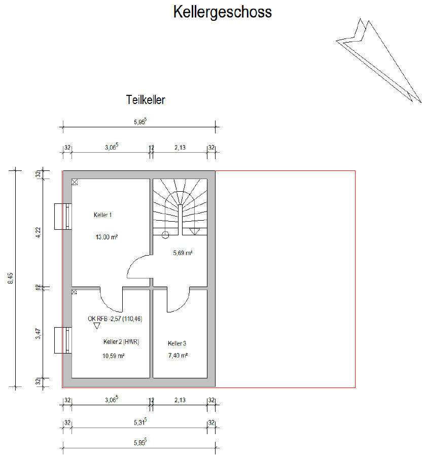

we are building a small partial basement with a waterproof membrane ("black tank") as follows:
Basement floor plan with three basement rooms, stairs and walls.
Basement floor plan: Basement 1, Basement 2 (utility room), Basement 3, staircase on the right.
We will take care of the basement windows and light wells ourselves. Currently, I am researching what would be practical in our case regarding dimensions, material type, and finally specific products and manufacturers. Below is a brief summary of some basic conditions:
  • Basement within the thermal envelope of a KfW55 energy-efficient house
    • 12 cm (5 inches) insulation
    • cast in place concrete
    • waterproof membrane ("black tank")
  • purely utility basement with
    • Basement 1: workshop and storage
    • Basement 2: utility room with equipment for air-to-water heat pump, photovoltaic system, electrical
    • Basement 3: storage for food supplies
    • no drainage inside the basement, so no connections for washing machine, sink, etc.
  • The soil report indicates an infiltration rate of 10E-3 to 10E-4 m/s, so water drains well through the gravelly/sandy soil
  • The backflow prevention level is above the window sill
  • The pictures show an extension to an existing semi-detached house
    • to the upper left a wall extends away, and directly to the left of the house there is a bicycle shed, so Basement 1 receives limited natural light
