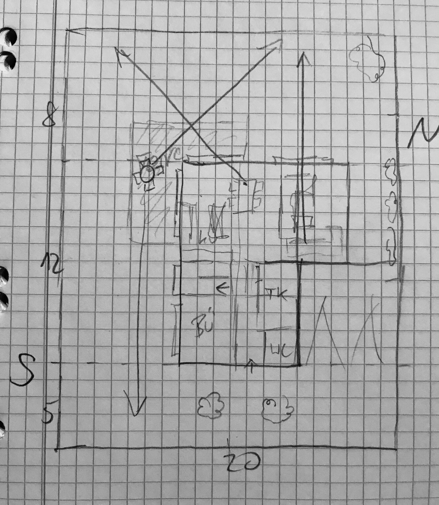

Regarding the plots: I understand the concerns, but here’s just a quick 5-minute sketch:
I don’t see any problem. The arrows indicate possible sight lines from the house and terrace into the garden. I didn’t take exact measurements, but the distances aren’t too short to consider the plot too small. That’s my opinion.
Regarding the plots: I understand the concern, but here’s a quick 5-minute sketch: Good morning,
Your sketch looks exactly like I imagined it 😉
Here is my latest "drawing." Of course, the rooms and stairwell are only sketched in provisionally. It’s not meant to be a floor plan yet—that will be the architect’s responsibility. It’s simply a rough idea of how the rooms and the overall house layout would fit on these building plots...
What discouraged me was what we discussed—the narrow garden strip.
Your house was a bit shorter. Maybe that could work as well.
Let’s wait and see. First the tender, then the application....
