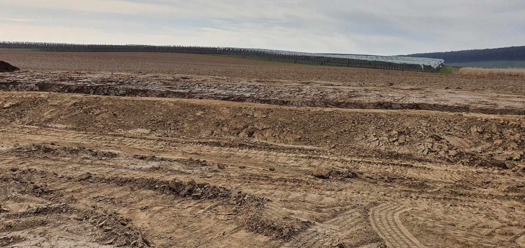

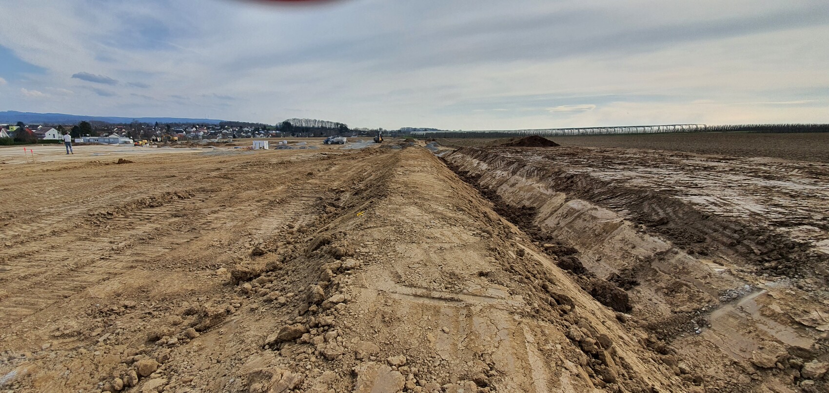

Hello, I’m back with some new updates.
I visited the construction site in the new development area on Friday. The water and sewage pipes have already been installed, and now they are slowly working on the road. So far, so good. Those are the only good news.
As I described in detail in previous posts, there is a raised embankment being built along the western border of my chosen plot as protection against rainwater. According to the building authority, this should be about 50-75cm (20-30 inches) high. Well… that’s what I thought. You also reassured me that this embankment could be nicely screened or combined with a hedge. The reality on site was disappointing—see pictures.
By the way, the “tsunami wall” (as the site manager affectionately called it) is completely on the property. The boundary is approximately where the lowest point in the ditch is (we measured this with a laser device). The embankment is about 3.5-4m (11.5-13 feet) wide. That can’t be right, or am I mistaken? That would be more than half the width of the garden!!!
Can the municipality do this? At a price of 320€ per square meter?
…Or am I worrying too much?
Which one did you choose in the end?2896 and 2898 were our first choices. Applications are still open until March 31. The photos were taken at the construction site 2896.
